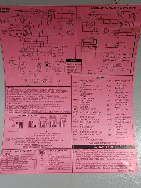

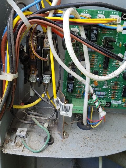

From what I read, It seemed that Cap going bad was number one problem so that is where I started and did not know at time that my meter could test it. Anyway, I connected cap back up and turned on AC last evening. It ran fine and cooled for about an hour then stopped cooling. I noticed fan was not turning. Shut it off. Today, I turned it on and fan and compressor came on, as the relay kicked closed, then the compressor kicked off, but fan still running. As it did, I immediately checked voltage on switched side of relay no voltage, fan still running and relay definitely popped out. picture of relay, with right side unswitched and left side switched. Status light -yellow- flashing 1 long, pause, 3 short, pause. If push in relay, the compressor kicks on. see photo. Is this code 31-high pressure switch?
It's a little hard to follow what you're doing.
The contactor closes - the compressor runs - the condensor fans runs.
So at this point the contactor is still closed. Then you said the fan was running and the compressor shut off and there is no power at the switched side of contactor.
If the condensor fan is running.... then the contactor needs to be closed.
If you have a high pressure issue.... that could point to a problem with the inside blower also.
Your unit may have two contactors or a contactor with a relay for the fan. I need a model number... I can't see enough detail from your posted diagram.

"If the condensor fan is running.... then the contactor needs to be closed"---nope! see photo above. The contactor is only switched on one leg of the 240. The hot wires come in from bottom (two black and a green with 240V between the black wires). The right side is not switched and goes right up to the top right side. The left side has the switch. So when the switch is out, the right leg still has voltage to ground of 120, but the left has 0V to ground. So the voltage between legs is 0V. Yet the fan is still running. when the switch is pushed in, there is 240V between the legs, and the compressor kicks on. The outdoor unit is 25HPA536A300, the indoor unit is FV4B
The fan is a 240vac fan. It needs 240vac to run. If the contactor is open..... then one leg of the 240vac is open and the fan shouldn't be running.
From manual...
NOTE: The outdoor fan motor will continue to operate for one minute after compressor shuts off, when the outdoor ambient is greater than or equal to 100_F/37.78_C.
Ok... that tells me that the contactor does not control the condensor fan.
Are you still getting the 31 fault ? That does indicate a high head pressure issue.
hvacpartners/docs/1009/public/0a/25hpa-3si.pdf
From manual...

yes, lights still blinking the same. Don't see 13 as code so guess it is 31. FYI, the fan runs for longer than one minute after the compressor is kicking off so this isn't normal fan operation. And it isn't over 100 degrees now either. It seems to run continuously. Strange that yesterday it kicked right off. See you are the pool guy too! Maybe just get you here in MD, LOL.
I see it says if pressure switch opened the fan will run for 15 minutes. I didn't let it go longer to see if it does shut off 15 minutes
