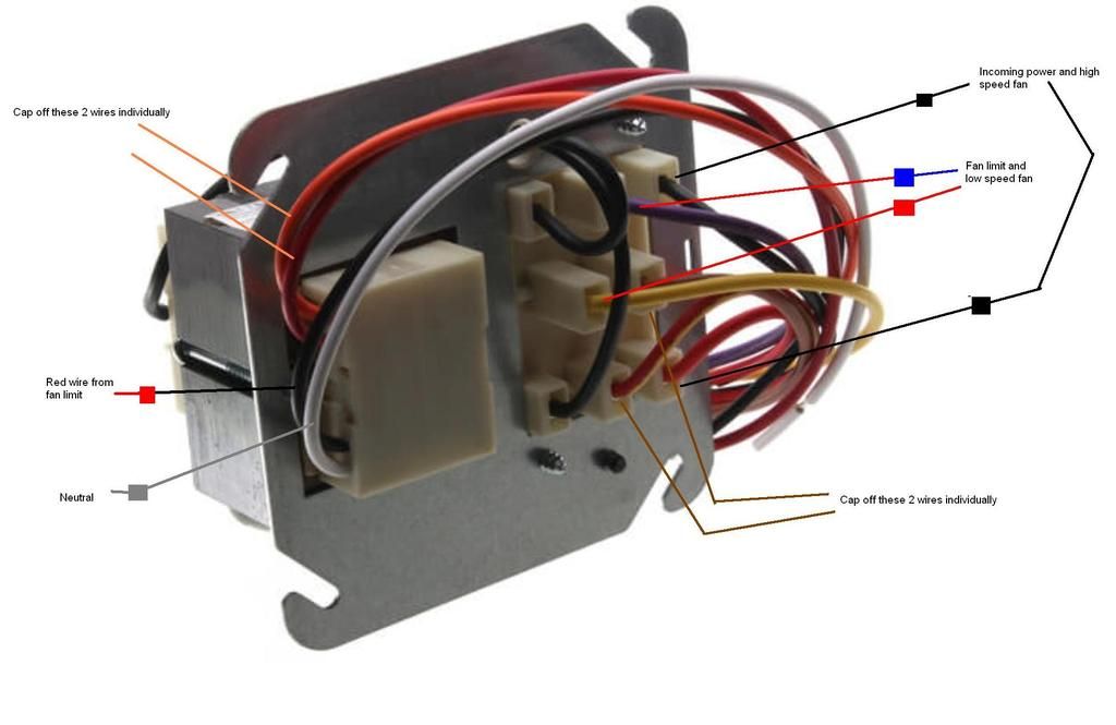

Old 05-17-18, 08:45 PM
Houston204's Avatar
Join Date: Oct 2009
Location: Texas
Posts: 7,425
Received 17 Votes on 14 Posts
If the fan runs when you connect the 2 black wires to your relay you can pick up a Mars 24010 DPDT fan center for $35 on Amazon.

Old 05-18-18, 05:28 AM
Houston204's Avatar
Join Date: Oct 2009
Location: Texas
Posts: 7,425
These are the connections that I would make when installing that $35 fan center.
I would number the existing wires with a sharpie or tape and a sharpie and then snap a few pictures before replacement.
Have you tested the old one yet?
It kinda needs to be replaced either way at this point.
