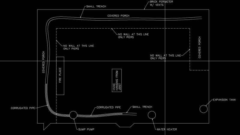

I did not have a chance to take any pictures last night. I drew up a quick sketch this morning to show what the layout is. The average ground to joist height is around 4.5 feet. The front of the house (top of sketch) is about 4' clear height and the back of the house is 5' clear height.

Black on white works better but I was able to enhance it to get a look at what you have, thanks.
I don't know how much you are prepared to tackle but I will outline what I feel should be done, and it is a lot. IMO, you need to install a partition wall along the dotted line to isolate the crawlspace under the house from under the leaky porch floors. That would allow the under porch area to remain as a vented space and the under house to become unvented and conditioned. One advantage will be, a new partition wall will be easier to insulate and air seal.
Then, the ground under the house will need to be completely covered with a vapor barrier. Sump pits are available that can be covered with water draining into the pit from below. Radon systems do that all the time.
The remaining exterior wall area that is not under the porch will need to be insulated with air sealing above. The link below will provide some good related information.
Building an Unvented Crawl Space | GreenBuildingAdvisor.com
Bud

Thanks for the info. I did not think about the colors as I usually make pdf's in black/white. I will see what I can do quick to fix that. I will take a look at the link. I wasnt planning to build a wall between the two spaces but if that is my only option then I guess I have no other choice. The porch actually has tongue and groove decking so the leaking is not terrible but it does happen from time to time. I wish I had a way to seal the deck so all of it could be conditioned space under the house.

When converting from a vented space to an unvented, the porch would also present the problem of insulating the bottom of the porch, which can't really be done if it leaks from above. Plus you would need to insulate the exterior walls.
Your climate is not as cold as mine and probably has never gotten cold enough to freeze any pipes.
But, if you read through that article they also talk about air quality. The air in damp musty crawlspaces is not what you want flowing through your home. Yet, during the cooler seasons something like 50% of the air you breathe comes from that crawlspace. In addition to energy savings, that is a very good reason for installing the vapor barrier and separating the porch areas from the under house areas.
You mentioned adding something to the floor to make it usable. I realize your floor is not exactly flat, but if you level it as best you can and then pour what is called a "rat slab" with your vapor barrier under it you will greatly improve that space. With proper planning it could be sloped to eliminate water issues and include drain paths to the sump. A thicker area could be raised to accommodate the partition walls and slope any exterior water away from the house.
It isn't just the floors you would be partitioning, it is the air space, that outside humid air in the summer can create a mold issue when it contacts a cool surface inside.
