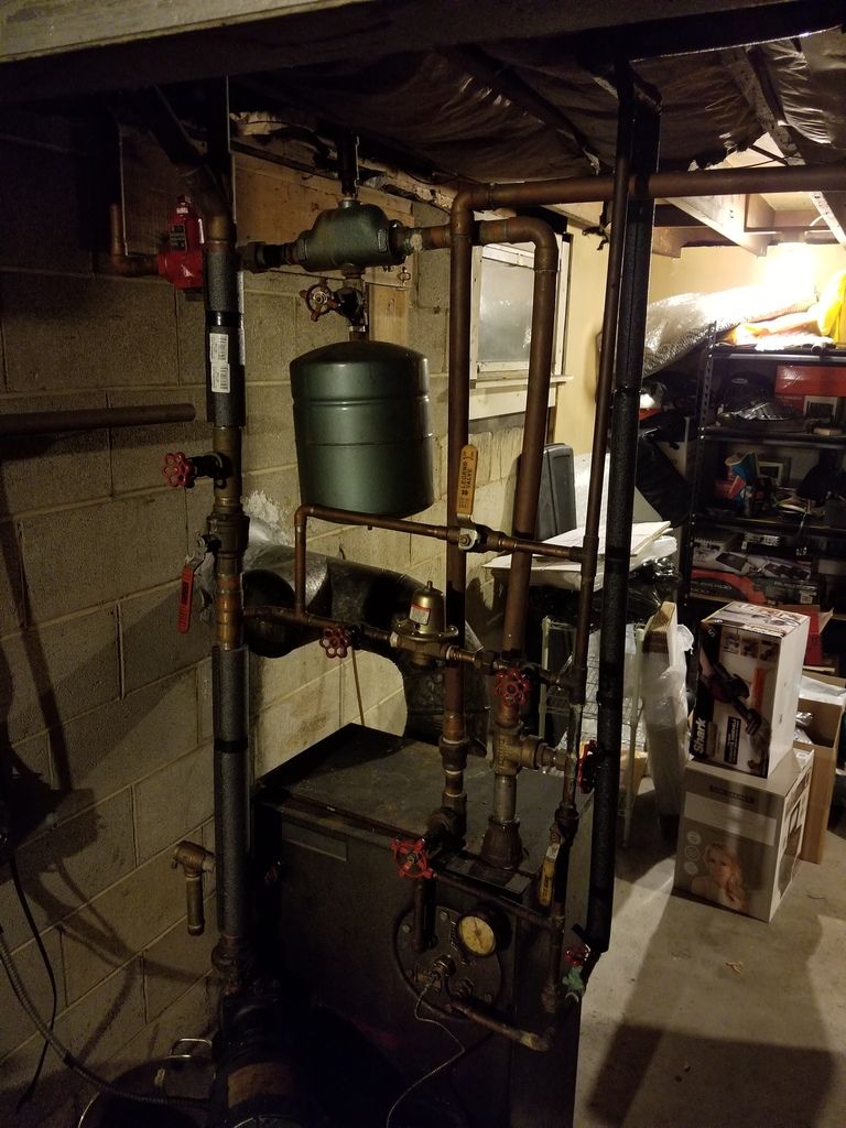

Your boiler looks like a Weil McLain P368-WT. The WT is for the tankless coil for you domestic hot water. Your tank is an Amtrol #30 extrol tank.
You already have the isolation valve so you don't have to drain your system to remove the tank. Just shut the valve off and if it holds unscrew the tank and install a new one.
You have 2 pipes coming out of the top of the boiler. The one on the right goes through your air scoop and extrol the way it should to help with the air and expansion. The one on the left does not. Where does that pipe go.
That tapping was made for a vent and not a feed line.
That boiler is older but not ancient. It probably dates back to the late 70's somewhere. Back then they didn't change designs or have so many models as today. That was and is a good boiler. I happened to have the same one in my house that I installed in 1984 and it's still going strong.
I only see 1 pump and no zone valves but 2 supplies and 2 returns so I'm assuming you have a somewhat of a split loop or 2 floors on 1 stat. They should have taken that left supply line after your flocontrol valve (red) near the wall instead of from the boiler.
When your boiler runs for hot water do you get heat where ever that line goes. There's nothing to stop the gravity flow. That's the job of that red valve.
By the way your domestic hot water is coming from that round tankless coil on the upper right hand corner of the boiler where your pressure gauge is. Those 2 pipes are your cold in and your hot out.
Just an observation I thought I'ld. share.

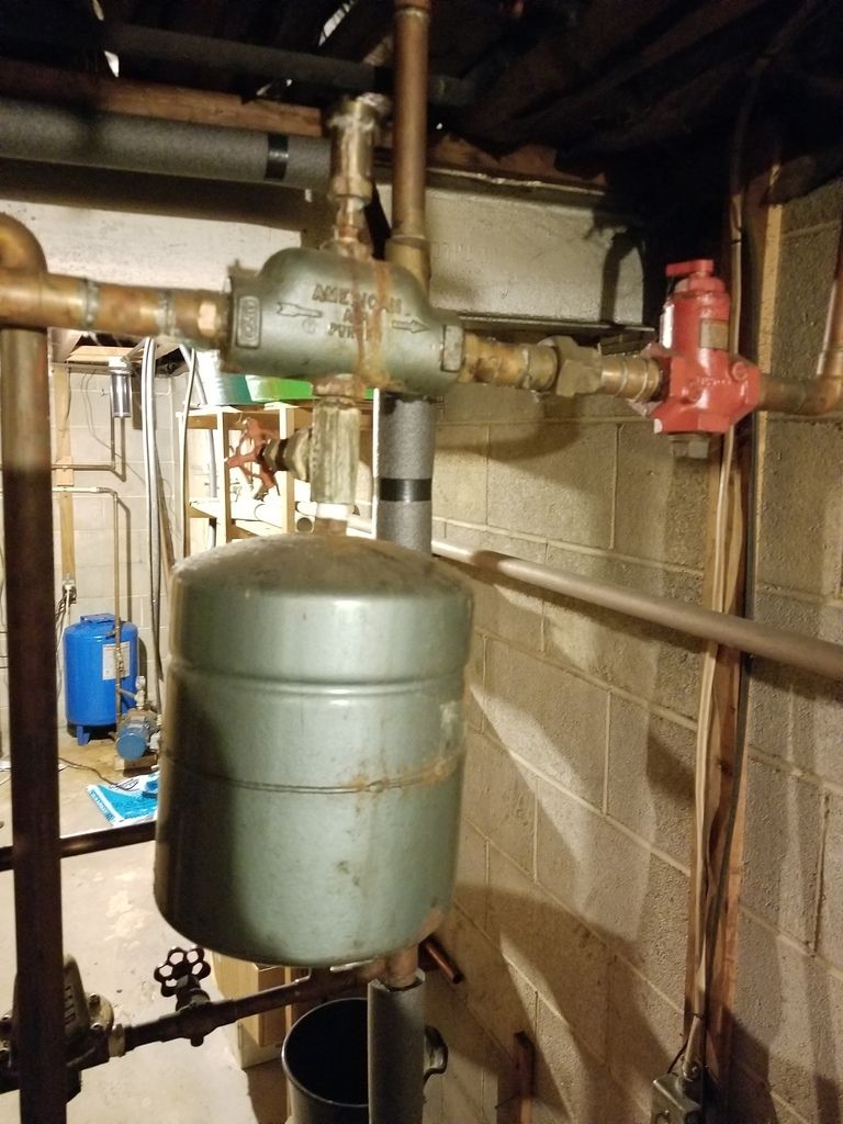

Are you saying you beleive the tank is this one? 102-1 - Amtrol 102-1 - #30 Extrol Expansion Tank (4.4 Gallon Volume)
It cant be that size as that one is physically larger. Mine is 8" wide and that one is 11. I beleive mine is 2 gallons. Thanx for that great observation btw even though I have no idea what most of that means, haha.

Yes, that is the size tank you need. There are different tank manufacturers and although they are the same capacity they may be different sizes. You definitely need at least the #30 which is what it looks like you have on there now.

Vermont, I had the pressure relief valve wide open while pumping air in. Was that not good enough? Should I have had the drain on the bottom of the boiler open? Doughess, stupid question but where do I mount that gauge? I just cjecked on the boiler and I beleive the gauge reads correct as it hit 30 psi then water started dripping quickly out of the relief valve til it went down to 20 psi.

P,
No matter what tank you install they all have 1/2" pipe.
You do not have to remove any boiler water and shouldn't IN YOUR CASE to recharge tank. You will not let out enough water, just compound your problem by letting fresh water back that brings air with it that must be bled.
For the moment forget about the pressure gauge and concentrate on your tank problem. Ignore the post about the pressure gauge. You are getting confused and you're making this more difficult than it has to be.
If you insist on listening to doug then I will bow out and put you in his hands which in your case will only do you an injustice.
I don't know how I can put this more simply.
1) Turn off your boiler
2) Close the valve above your extrol tank
3)Remove the tank being careful of the weight of a full waterlogged tank being about 35lbs.
4) An option is to drain the removed tank after and recharge or buy a new one.
5) If the tank doesn't fit by the piping add a 1/2" nipple and a 1/2"elbow another nipple and elbow to relocate tank and get away from the copper bypass line.
6)Open valve above tank
7)pressurize system if needed and bleed if necessary which shouldn't be if directions are followed.
8)Turn on boiler and test for proper operation.
You are getting street (house) pressure confused with boiler pressure. They are two totally different things.
FORGET ABOUT HOUSE PRESSURE FOR NOW. If your faucet pressure is fine then you have no problem. I see a BLUE tank in the picture which is telling me you most likely have WELL WATER. Forget about that for now.
I hope this helps a little.

Regretfully have to bring this thread back. So I replaced the expansion tank with the extrol #30. Then I sprung a leak on a joint going to the T that the tank is on. Tried desperately tonight to resolder it but that joiont is NOT taking. Also the only way I could get the water out of the pipe was to take the tank back off. No matter what valve I closed or what I drained the joint wouldnt get hot enough. SO, should I just replace the copper or would PVC work? Im not sure pvc would suppert much weight without bracing.
#34
You can not solder a copper joint as long as there is water in that pipe. You have to be able to isolate that section of pipe to re-solder the joint. Also, if you are trying to re-solder the joint in place, the joint is contaminated and dirty so the solder won't adhere to the copper. There may be a type of acid flux that will work but I would leave that up to a person with a lot of experience in soldering. The best solution would be to remove the piece with the bad joint so the fittings can be cleaned and fluxed properly. And "NO" you can not use plastic! And one last thing, I hope you pre-charged the tank with 12 PSIG of air pressure before installing it.
#35
Join Date: Jan 2006
Location: usa
Posts: 390
Received 0 Upvotes
Yea I tried to remove the water but the only way was to remove the tank. Tried turning the valves off and draining from several places but no luck. What is the purpose of the red valve? I turned the knob on top off and noticed it was hardly open.
#36
That red valve is not a shut off valve, it is a flow control valve to keep the hot boiler water from flowing by gravity to the radiators when the boiler is supposed to be shut down. Movement through this device is by pump operation only. You should turn it closed, (clockwise) to it's normal position.
#37
panderamatt: No matter what valve I closed or what I drained the joint wouldnt get hot enough.
That is classic sign of water in pipe when heating copper soldered pipe fittings . With plenty of heat ,if solder does not melt there is water in there. I have seen fittings turn purple/blue from high heat and solder still does not melt.

pantera –
I don’t want to muddy the waters here, and I’m no expert for sure. I don’t know which joint you are saying is leaking but I see a union in the picture which is there so things can be taken apart. The air scoop to the left of the union is also threaded and that can also be unscrewed if need be.
I don’t know whether removing any of that would help you to keep the joint dry as you solder. But it looks like it might if the joint that is leaking is near that air scoop. You would need to drain the water from that piping before you opened up the union or you will get a big flood. If there are no other shutoff valves around that piping then I think you would have to drain a lot of water from the system to bring the water level down below the piping to be soldered.
In other words I think there is a good chance that even after draining the water from the pipe, it won’t be dry enough to solder unless you open things up and let it all drip out and dry with a rag.
Maybe the other guys would disagree. But I know that just a little bit of water sitting in the pipe and you can heat all day long and you still can’t solder.
I think you probably should support that tank somehow. I wonder if because of the increased size and extra weight it put more stress on a joint and the joint sprung a leak.

P,
Can you post a pic of the leak. From the pic I see you do have some options to remove the water.
As Z pointed out you have a union that can be opened to let water drain out and if you removed the tank and open the shutoff above it water would drain out there also
I would start by getting hangers or wire or anything to support that pipe before you start to work. I would put a hanger between the air scoop and union and another between the union and Flocheck (red valve) to take the weight off the pipe and joints. Depending where the leak is you may want another hanger before the air scoop also.
You do not want any weight on the pipe of the joint to be soldered.
The handle on that red valve should be closed all the way to prevent water from coming back to the boiler. It is a one way check valve. By opening it up you allowed water to come back to where you were trying to solder.
Remove your expansion tank to take the weight off of the pipe before you solder.
What kind of torch you have depends on how much heat you produce. Once you open that pipe, either by union or tank you can pitch that pipe a little so the water will flow out of the opening.
Once open, if you heat the pipe you can boil the water out and with the pipe pitched it will run right out.
As you found out you cannot solder with water in the pipe.
Sometime you can resolder a joint but you must clean it completely with sand cloth and flux it real good and if you can get the solder to melt then you can add solder also. An extremely clean joint, all the way around and good flux and enough heat is the key.
There does become a point though where you can overheat the joint and it becomes unsolderable, if that's a word. The pipe changes properties or something and cannot be soldered and must be replaced.
Sometime it's easier to cut out the section and replace with new fitting and couplings.
Hope this helps a little.
