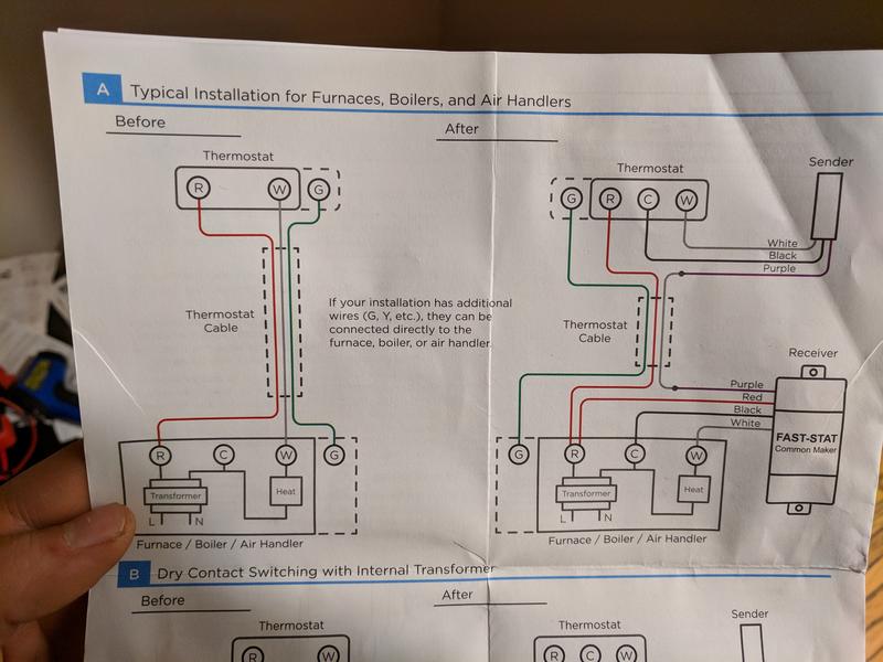

Honeywell RA89A relay controls a circulating pump.
This relay doesn't expose C wire. I soldered my own.
When i connect a thermostat directly to RED, WHITE, BLACK (common) everything works.
Using a FAST-STAT common it does not, what could be the reason?
I bypassed the thermostat wire, wired everything at the relay, don't see how it can be done any differently.

Welcome to the forums.
You took that control apart and soldered a black wire to the relay/transformer junction ?
If yes..... you need to measure between that and each TT terminal. The T terminal that shows 24vAC is R and the other is W.

I figured that out.
Reading the FAST-STAT troubleshooting guide, it says the transformer must be between 23 - 28v. Mine reads 22v and change, can that really be the problem?
I have recommended them to people but as a pro..... I just run a new cable.
So.... I can't advise you if that voltage is a problem.
Actually..... I think your problem may be that the transformer in that control may not be large enough to run the relay and your stat. It may only be a 5va or possibly 10va transformer.
