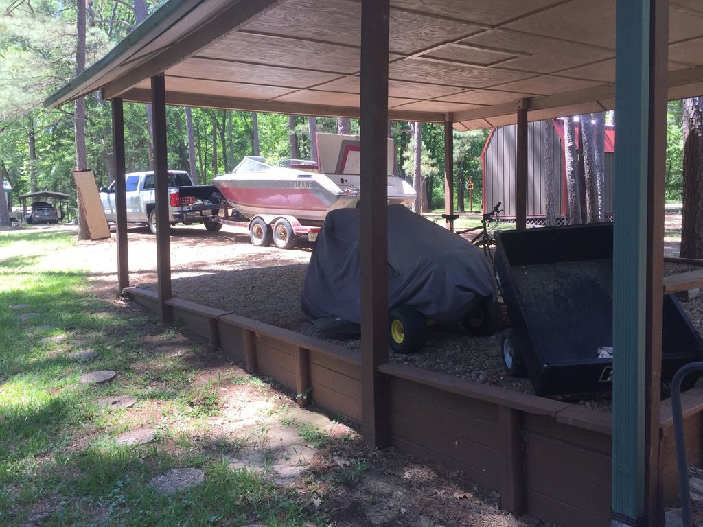

I have a free standing carport at lake house that is constructed of woden posts and has retaining wall on three sides (North, East,South) with wood boards making up the retaining wall and driveway entering the fourth side(West) of the carport I dont know much about construction and I didnt think to take pics while there but I will get wsome and post. The four primary post are larger then the smaller posts that appear to be retaing the soil/gravel. The driveway is gravel of white stone approximately 1" stone. I think its limestone but not sure. Seems to me that the walls were built on three sides due to uneven terrain and bacl filed with the rock. The South wall is leaning I suppose because the lot drains that direction as well as to the East however I do not notice bulging on the East wall. I assume the bulging is due to water draining or just poor supporting structure. There are smaller posts that appear to be supporting the wall boards and they are leaning outward.
My thought on repair is excavate the gravel and then staighten/replace the posts and replace the boards. So I dont know what I dont know about this project and I'm all ears. I hope the description is enough to get started. I'll post pics and or videos (if the forum supports them) next chance I get. Does fourum support iphone video? Sorry for newbie questions.

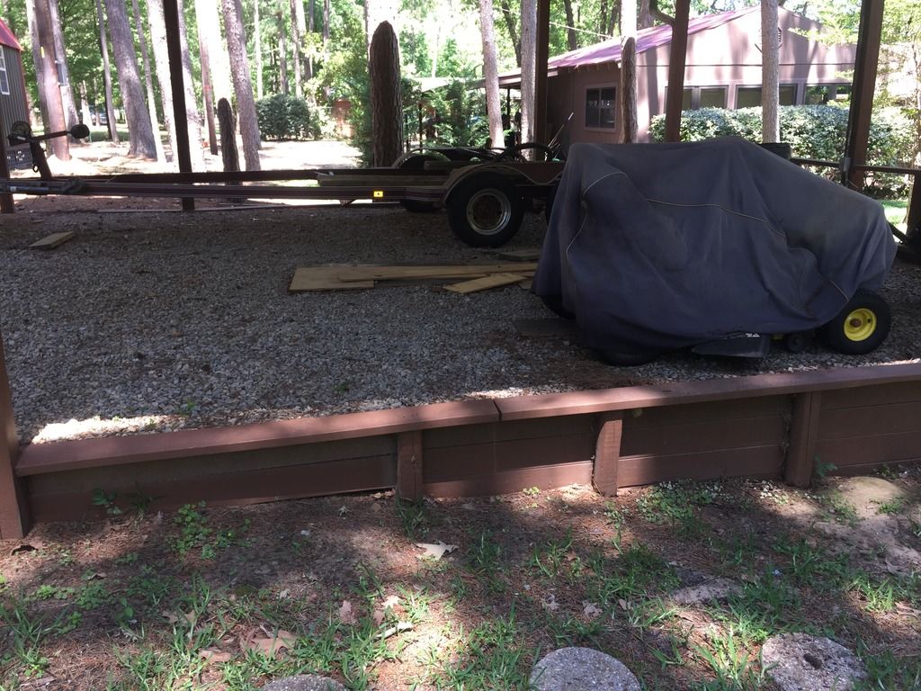

So here are the pics. After taking these, I am wondering if the weight of my riding lawn mower is causing the shift in the gravel and creating the lateral force on the wall. As you can see in one of the pics, I park it along thatg wall and I often go back and forth when backing a trailer.
Here is the wide angle, the "bulge" in the wall cant really be seen here but the top boards are separated about 1/3 of the way from the opposite end.

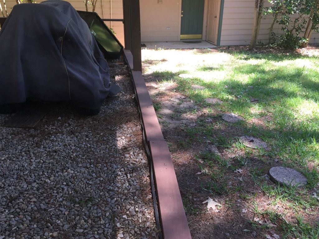

Here is straight on view of the bulge
Here you can see the bulge
Here is close up
I can see on one of the main suport posts where there are vertical cracks that have opened.
Any advice on following plus anythiong else I should think of:

For a wall made out of 2xs it's in surprisingly good shape. The weight of the dirt/gravel is too much to expect a wall like that not to bend/lean. I'd remove it, pour a footer and lay block. A backhoe is the quickest way to excavate but a shovel is cheaper
Most people greatly under estimate the amount of force on a retaining wall. Basically what is there is not a retaining wall.
The first step is to remove the stone on the back side to relieve the pressure and prevent further damage to the posts supporting the roof. Then you need to read up on retaining walls and pick a method that best suits your situation. It will be difficult to get a wall to coincide exactly with the edge of your carport like now but you can get close. Generally though expect the construction to be MUCH heavier duty than what you have now. A good bit of the work will be below grade to key or anchor the wall into the ground so it cannot be pushed sideways.
