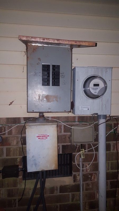

Hello, I recently purchased a home built in 1980. On the exterior of the home, next to the meter, is a breaker panel with six breakers. I have started having issues with one of the breaker tripping if we run the dryer and anything else that uses a good bit of electricity (full house attic fan, microwave and dishwasher, dishwasher and washing machine...). I have narrowed down what the six breakers supply as nothing is marked.
50A - Stove 40A -Entire house
60A - Downstairs Air handler 40A - Upstairs Heat pump
60A - Upstairs Air handler 40A - Downstairs Heat pump
I am no electrician but it doesnt seem correct to have an entire house (minus the items on the other 5 breakers) running on a 40A breaker. I looked at the wire casing to try and determine the gauge of the wires but I didnt see any markings. They appear to be of the same size as the 50A and 60A breaker wires but I do not want to assume. I am looking for any advice or guidance that anyone can offer. The heat pump breakers seem to be over rated for the wire size but I am also unsure of this one also. I will attach a picture for reference. I also know that the bottom right 40A is double tapped, my pool pump is attached to this breaker. That will be my next task to fix once I figure out the breaker tripping. Any advice on fixing that would be great also. The dryer is on its own breaker inside the house in the sub panel.....
http://i37.photobucket.com/albums/e9...pssjgsdndd.jpg
That appears to be your main panel.
Can you elaborate. Are you saying each of these breakers supplies two loads directly or are each of these connected to a subpnanel that has breakers for these devices..
I hijacked your picture. That is a main disconnect panel. It appears to be a 200A service and you are pushing it to the max.
40A for the house is definitely not enough power. I circled the double connections on a 2P40A breaker in red. Is this the house breaker ? You should not have two circuits connected into one breaker.
In the blue box..... the neutrals/grounds are all stuffed into one lug and there is no anti oxidant on the wires. Actually... I don't see any anti oxidant on any of the aluminum wires.
Not sure how old the house and wiring is but I don't see the correct wiring to the indoor hose panel either. It should be fed with a four wire cable.
The OP has all electric heating. The 2P60's feed the two air handlers with backup electric heat coils.
The 2P40's supply the two outside heat pump condensors.

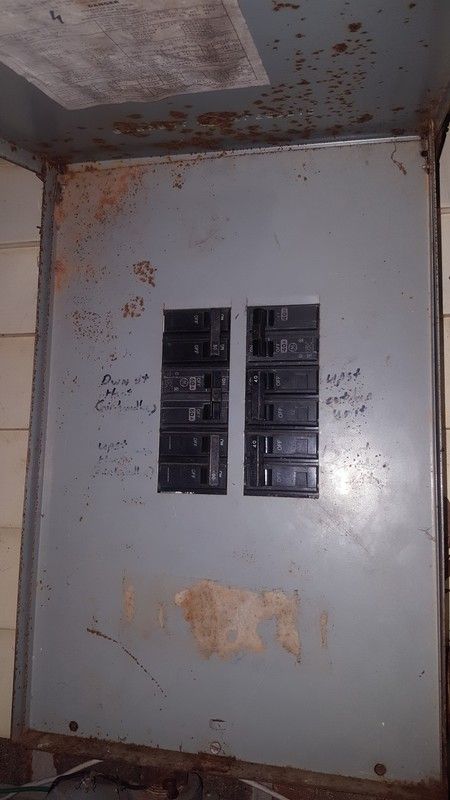

That is my main panel. The double tap breaker is one of the Heat pump breakers with a pool pump attached to it. Not sure why it was wired like that but its on the list of issues. The house was built in 1980, I assume this all the original layout excluding the pool pump. The breaker in the top right corner is the house breaker. None of the other breakers in this panel are attached to the interior sub panel. These are main (and only) breakers for all of those items.
Join Date: Jul 2006
Posts: 104
Received 0 Upvotes
Ray2047, I was giving the location of each breaker in the main panel.
On the left from top to bottom is....
50A to Stove
60A to Downstairs Air handler
60A to Upstairs Air handler
On the right from top to bottom is....
40A to sub panel inside house
40A to upstairs Heat pump
40A to downstairs Heat pump
The 5 breakers that are for specific items are the only breakers for those items. Only the 40A in the top right goes to the sub panel.
50A to Stove

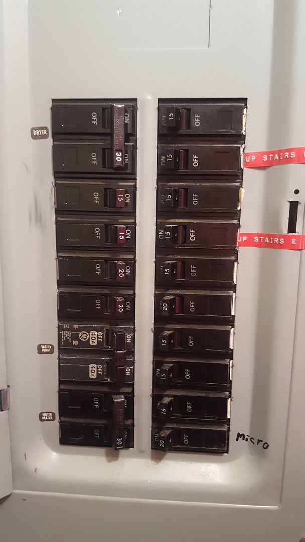

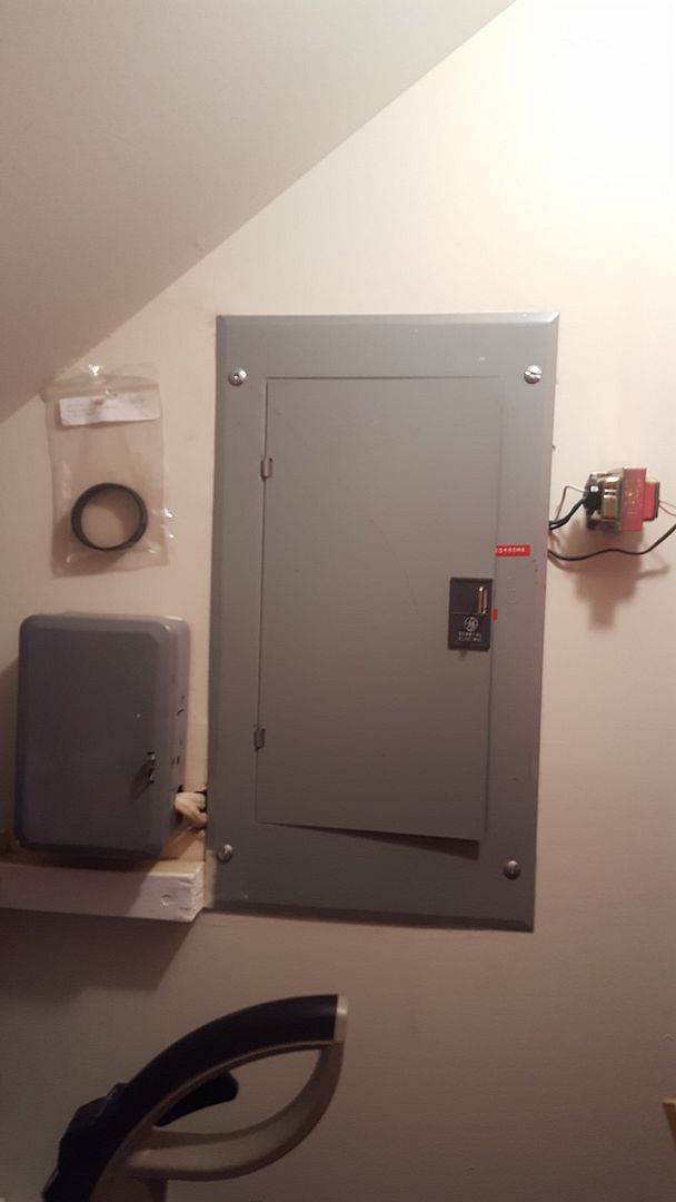

Thanks Furd. I will get a picture of the inside of the sub panel tonight. I have a picture of the exterior but all it shows is its a GE. Is it typical to have a main panel on the exterior with standard breakers and then a sub panel inside? This is all new to me as my previous home only had one panel in the garage with the main shut off.
Here are all the pics I currently have.. Will get the other posted this evening.

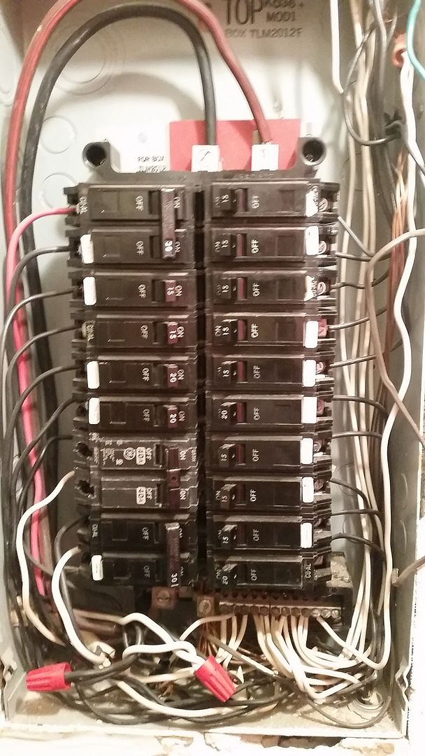

There should be a label on the inside of the door on your sub-panel that states the ampere rating of the panel. There should also be a model number that may have something like 20-40 in the number, or maybe 2-30 or maybe just 20. There will also be a diagram showing various arrangements of circuit breakers.
I notice that there are 20 spaces for full-size circuit breakers. Often, but not always, such a panel will also allow for "tandem" circuit breakers in some positions. The model number and the diagram will confirm whether or not your panel will accept tandems.
Join Date: Jul 2006
Posts: 104
Received 0 Upvotes
Join Date: Mar 2006
Posts: 16,321
Received 38 Upvotes
30 Posts
That is a 20 space, 24 circuit panel. The bottom two spaces on each side may use tandem circuit breakers. In other words, you have a maximum of four more single pole (120 volt) circuits that can be added to that panel.
It is also rated at 125 amperes maximum so IF you can replace the existing feeder conductors with larger ones (dependent upon the temperature rating of the main lugs, which I cannot find) you can increase the load on that panel significantly.

I know its been awhile but I finally found some markings on the wire casing. For some reason I was thinking the markings would be on the black or read wire.... This is what I found / 2-4 al 1-4 al type SE cable style U type XHHW condos 600 volt Cerro. The stamp is very hard to read and this is what I came up with reading several stamps along the wire. Can anyone tell me what wire I have? Have I been correct in assuming it is 6 gauge?

So its 4 gauge wire instead of 6 gauge? I assume thats what #4 means? I am researching now but figured I would ask. If so, Its saying I have two coated #4 wires and one bare #4 wire. Since its aluminum I assume it would be rated for a 50A breaker? Not a 60A or the currently installed 40A?

Number 4 aluminum is rated at 55 amperes but code allows you to go to the next higher standard breaker when the rating is in-between standard breaker sizes. So, yes, you CAN go to the 60 ampere circuit breaker.
More of a concern is that you have a three-wire feed to a sub-panel. This was once fairly common but not so today.

It's aluminum SEU with two #4 phase conductors with one #4 neutral that is concentric.
If I installed a larger feed to the subpanel would I be pushing the limits of the existing main panel?
There is a likelihood you may need to change your entire service including the meter socket.
