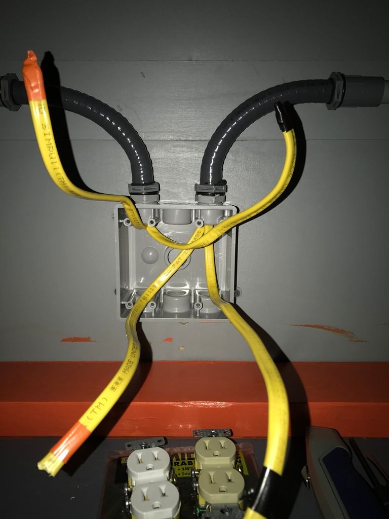

Hey all. I am trying to setup a cargo trailer with electric. The trailer is for RC racing. The places we will pull it to do not have 30 or 50 amp hookups like a camp ground. It is usually a block of standard outdoor outlets.
My idea was to run two 15 amp circuits totally independently but in the same boxes. In the pictures you will see white outlets and tan outlets. I have no idea if this will work, but the idea was to have everything split into different circuits in case we ever need heavy draws. The outside of the trailer has two RV style shore inlets. The idea being to just plug two extension cords in (if we ever need both circuits at the same time).

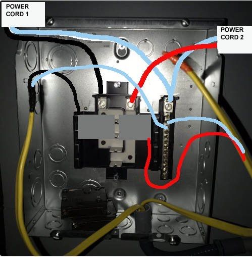

I kept everything separated and wrapped each outlet in electrical tape. When I get to the breaker box I realized I may have a flawed design. Is it possible to wire two totally different circuits in this same box? The photo with the lines drawn is a rough idea, but I'm not sure it would work.

Looks good. Would have been much easier using individual wires instead of NM-b cable.
With that type of setup..... the grounds would be separated from the neutrals.
The white/neutrals will connect in that existing block.
The grounds would go to a separate ground block directly bolted to the metal enclosure.
You're going to have a problem. I'm fairly certain your campgrounds will GFI protected circuits which will trip when you have the neutrals from two circuits connected together.
You'd be better off just connecting directly to 2 power cords and not use a panel.

Could I put a separate neutral bar in and run both circuits 100% independently? Can the grounds and neutrals from a single circuit go together? If so, then can I have two neutral bars, each with a neutral and a ground, then each hot going to their "side" then use one breaker on both sides?

The grounds must be shared. The neutrals must remain separated.

So the second image would work, or would I still run into issues with the GFI's? Usually these tracks have a board full of outdoor outlets. I assume I will have to plug into two different outlets rather than both plugs on the same outlet... Correct?

The second diagram illustrates the correct wiring.
The greens and whites cannot touch.

The neutral bar is proving to be harder to find than I thought. I guess a ground bar can't be used, correct? It needs to be insulated?
