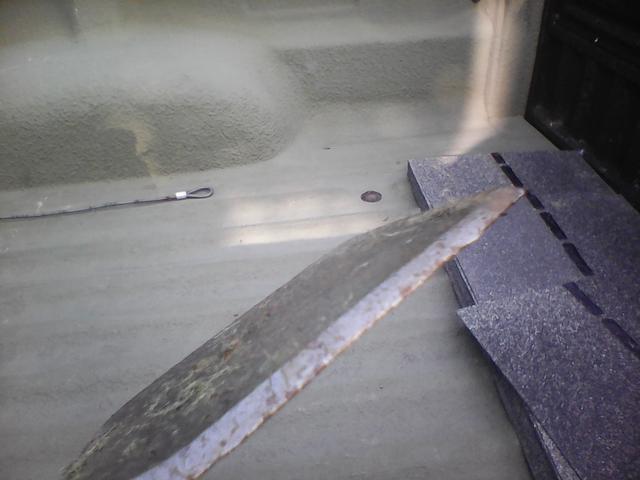

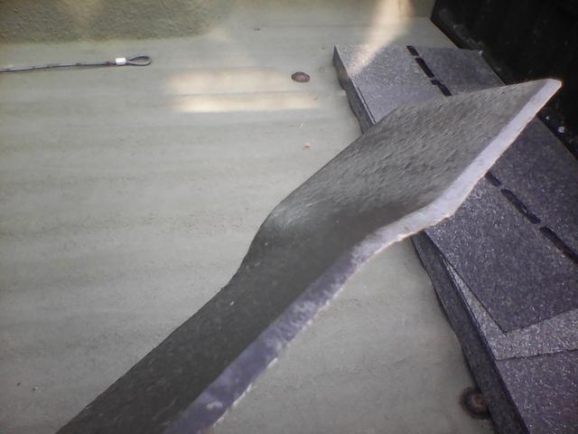

For what's they're worth I've taken photos of each end of the mower blade so it might be seen/determined the condition of the edge(s) and so as to obtain any further comments thereof. I do have a grinding wheel (bench type) a but the grit on the wheel is not particularly fine; don't really want to spend bucks for a new finer-grit wheel for one mower blade, but could I suppose. Also I have an angle grinder I suppose I could use, with varying grits of wheels for it too. Looks pretty easy/straightforward when the guys on youtube demonstrate filing mower blades with metal file, although I'm not sure whether my blade would be necessarily be considered "totally nicked and blunted" but perhaps it is.

That blade looks to be in very good condition, file away!

Although that doesn't look bad as Marq said I usually us a power tool, belt sander, angle grinder, bench grinder. Don't get carried away with making it ready to carve the Thanksgiving turkey and big nicks can stay as opposed to removing a lot of metal. Do balance.
