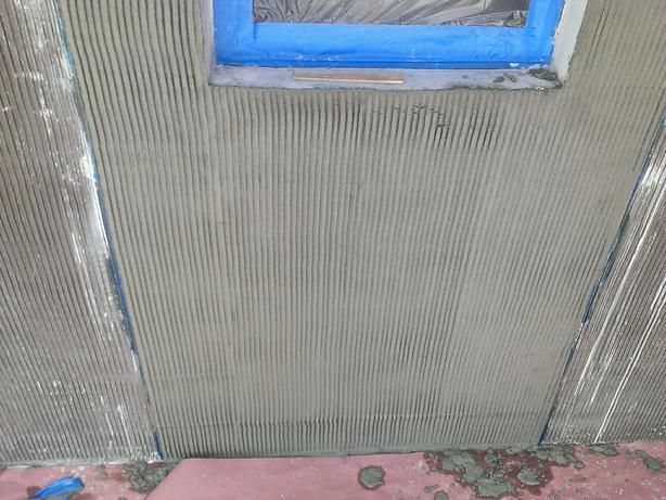

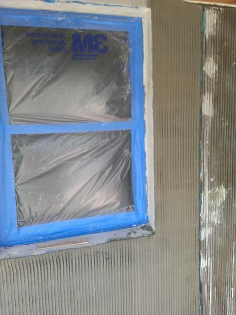

Well, I got some results.
Practiced on a cement board a few times and went for it.
Out of the 7 windows I need to patch I got 5 done. The 12" flat wire tool does create a pattern like the existing, but it's real tricky to use.

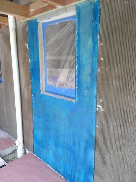

I started off and did a bit more grinding on the wall to recess it a bit more. Then I applied a coat of bonding agent on the area for the stucco.
I did the top edge, then I progressed from left to right. Applied about 18" width of stucco, then used the 12" tool to do one segment of texture, then immediately go apply another 18" of smooth stucco, then more texture.
If the existing pattern is not perfectly straight I had to follow the same as I move from top to bottom.
Also, if the stucco is too thick in some areas, the stucco may crumble as the tool pass through it. I tried varying the angle and speed, that didn't seem to make a big difference.
Here are some pictures of the results.
Also as I am on an angle from the top down, by the time I get to about 18" from the bottom I had to stop, and go from the bottom up, to meet the same lines. I tried this a few times and I was able to make the lines meet, but I can't avoid the slight "budge" formed where the lines meet. You can see in the next pictures near the bottom where the lines meet and the pattern is disrupted.

There are areas I did the new stucco that in general as I step back it looks good, but I may have an area say 4"x4" where I messed up where the stucco crumbled or cracked and fell off as the tool passed it.
Once the entire area is dried and set. I would like to repair that area. If I apply a small area of fresh stucco then run the tool over it again in the small area, will that blend in OK or will it be very obvious?
