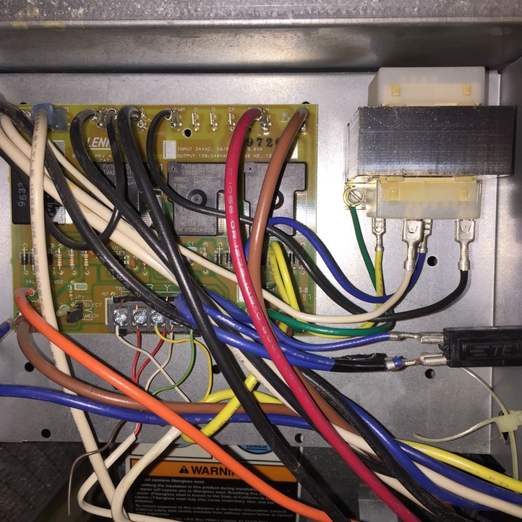

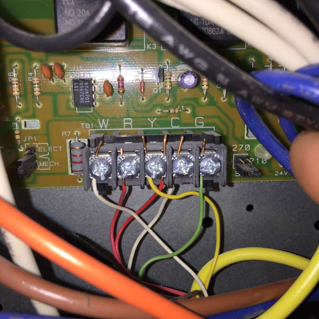

Hi there,
I tried to replace my old thermostat(4 wires) to a new digital thermostat(5 wires). In order to that, I followed some guidelines online on how to bypass the wiring at the furnace circuit board. After turning the breaker fuse on, the next thing I noticed is there's power to the thermostat. So I thought I swapped the old thermostat back, and placed all the wiring to the old setting, the result was no power to the old thermostat either.
This whole process made to think that I had blown something. So these are the steps that I'd taken so far: replaced breaker fuse, transformer and circuit board fuse in the furnace. The result is still no power to the thermostat.
Can somebody please tell me what had gone wrong?

Welcome to the forums.
What is a breaker - fuse ??
There is a circuit breaker or there is a replaceable fuse.
Your asking us to troubleshoot something that we cannot see.
I need a part number off the control board.
Did you turn off power when doing the wiring ?
Do you have a meter ?
Have you checked that the transformer is putting out 24vac ?
Do you know that the furnace won't work when the blower door is open ?
Pictures are a BIG help. http://www.doityourself.com/forum/el...-pictures.html

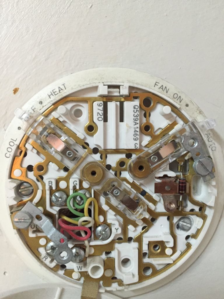

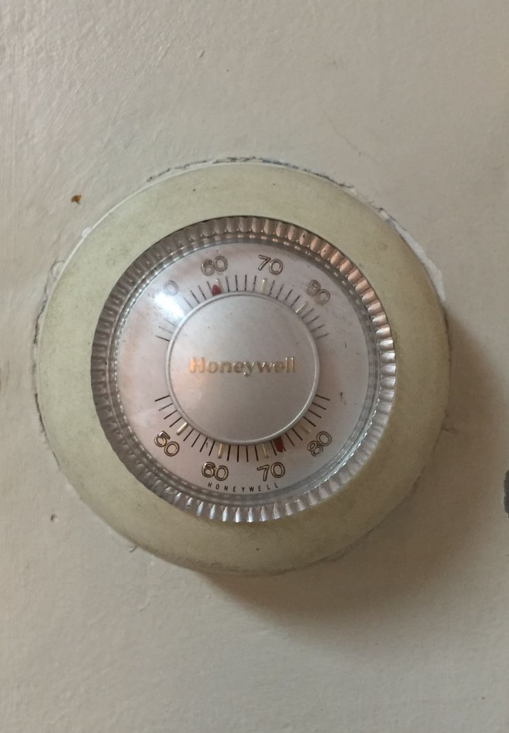

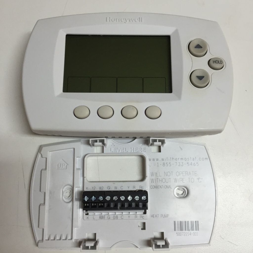

Next question, is it possible to replace my old thermostat to a digital one? Because my old one doesn't have wire to 'C', but the digital one stated that WILL NOT OPERATE WITHOUT WIRE TO 'C'. Please refer to the pictures below:

Hi,
I see you started a second thread. It's no longer with us.
Apologies for not replying back to this one.
It's unfortunate that you choose a stat that requires a Connection as there are quite a few similar ones that use batteries.
We can make an easy wiring change using your four wires but you will lose the ability to run just the blower from the stat.
