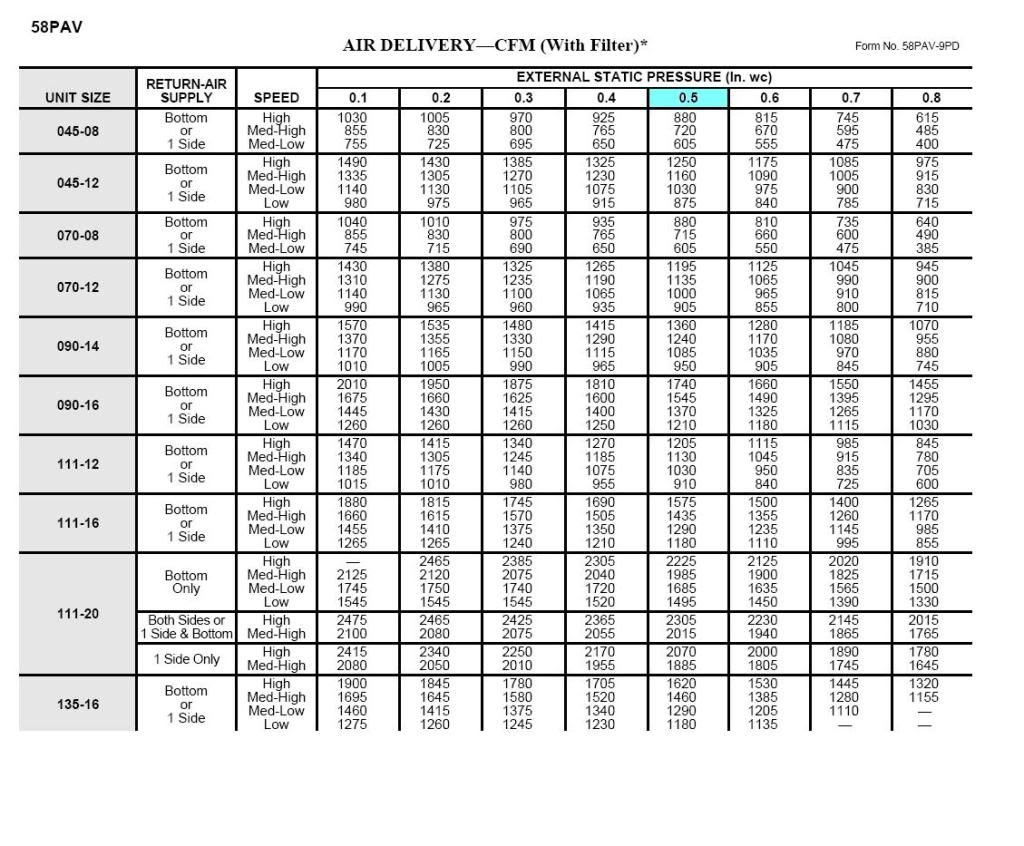

Another thing to consider is the Merv rating. A Merv 12 will filter more particles than a Merv 10 but it would also be more restrictive. I usually select the Merv 10 for my home.
If an ECM motor is in use it will pull more amps when a more restrictive filter is in use but can deliver the desired CFM output til near 1 inch water column external static pressure.
A standard PSC motor will deliver less air as you restrict airflow more.
A manometer and the furnace manual can be used to measure the CFM output of a furnace at various ESP ranges.
