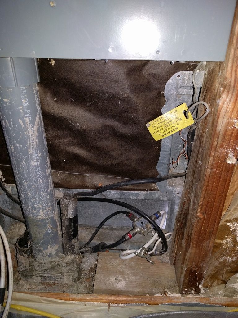

Should I install rigid foil faced foam insualation here?
I had to remove part of the drywall and insulation in my living rood because of the water leak.
I very rarely had to use the little access door for the coax and phone cables on the other (exterior) side of this wall, but when I did I hated fumbling around the insulation.
Is it a good idea to add a piece of a 2" rigid foam insulation right behind the door and fill the rest of it with fiberglass?
I realize, there's nothing wrong with rigid foam except maybe there is. The stuff I have has foil on both sides so when I started figuring out how best to put it in, it downed on me...
Would it possibly start interfering with coax cables? Yes it's shielded, but there is a lot of data flowing through it and it's a lot of foil around it.
Good/bad or don't matter?
Thanks!

I dont think it will interfere with the coax.
there has to be a signal for something to interfere, so there would have to be something flowing through the foil.
but then again I am a Mechanical Engineer and just assuming.
