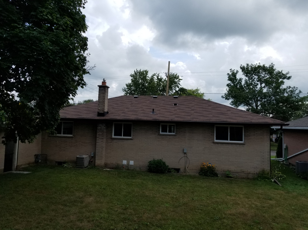

Old 07-25-18, 03:51 PM
W
Join Date: Sep 2011
Location: Canada
Posts: 409
Received 1 Vote on 1 Post
Got a quote today for top up.
I have 5 roof vents and he says theres about a low vent every 10 to 12 feet .
house is about 1200 sqft
so is this adequate?
Old 07-25-18, 04:07 PM
B
Join Date: Oct 2008
Location: New England
Posts: 10,532
Received 42 Votes on 38 Posts
At 1,200 ft² the normal guidance for your age home is 1 ft² of NFA (net free area) for every 150 ft² of attic floor. Dividing 1200 by 150 gives you 8 ft² of total NFA for high and low. Divide that equally and you need 4 ft² for high and 4 ft² for low.
Your next task is identifying how much NFA your current vents are providing. With pictures we can help guess.
IMO, the person who gave you the quote should have provided this information.

Old 07-25-18, 04:12 PM
W
Join Date: Sep 2011
Location: Canada
Posts: 409
I still should tell them to put fiberglass at each vent so blown in doesnt fall into sofit?
heres a pic . One vent isn't shown in pic cause it's on other side if house .
Even in the past with Insulation companies they have no idea that there is a formula/different style rafters etc etc . No one even knows about putting fiberglass batting at vent . They just wanna cash in

Old 07-25-18, 04:31 PM
B
Join Date: Oct 2008
Posts: 10,532
Looks like you are ok for high vents but I can't see the low vents in the soffit. However, I suspect there is not enough low vent area. So two questions.
1. can you take a picture of the vents in the soffit from below them, not from the attic.
2. From that picture or if you can tell me, is the space above the soffit open such that air entering the existing soffit vents can flow to any rafter bay.
Bud
  #22
Old 07-25-18, 04:34 PM
W
Join Date: Sep 2011
Location: Canada
Posts: 409
Soffits are all perforated . But suppsueeldy only cut out every 10 to 12 feet
  #23
Old 07-25-18, 04:43 PM
B
Join Date: Oct 2008
Posts: 10,532
The vinyl can be removed to expose whatever is up there for soffits. For the current insulation work there should be baffles in EVERY rafter bay and a fold of batt insulation stuff near the bottom to block the new blown in insulation from filling the soffits. be sure the fold of fiberglass insulation doesn't crush the baffles or block the air flow from soffit to ridge above the baffle.
Bud
