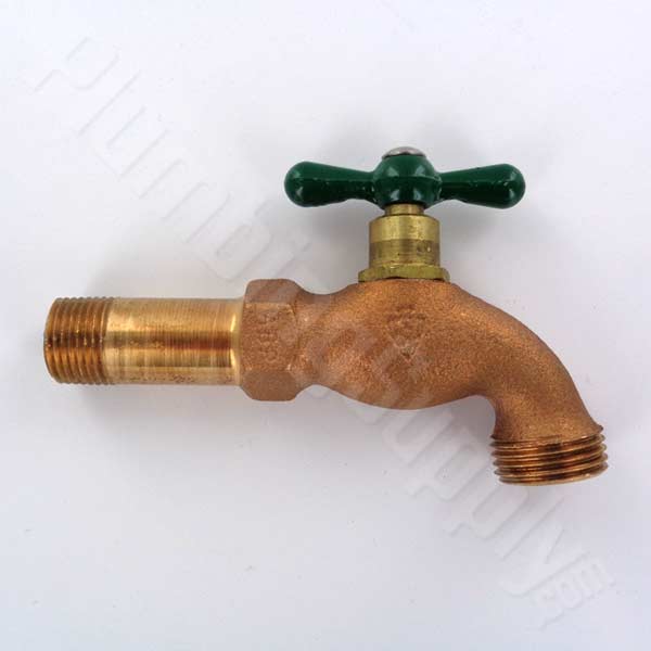

sorry what I meant to say is the pipe out of the home comes out straight. There is no bend at the end as the valve is higher up on mine.
I'd like to get it curved like this picture so the opening points downward.
https://www.plumbingsupply.com/image...t-mipsxmht.jpg
Thanks for the tip about water running once at a time. My water pressure is good but if I go w/ the timer or Y hose then I will need to test it out. Once at a time is fine w/ me. No hurry watering the lawn.
There are fittings you can screw onto the end of your sillcock to make the outlet angle downward. They are a bit rare so you will probably have to order it online. Make sure you get something good quality as cheap ones can have a small internal passage that will restrict water flow. Y fittings are the same way. Cheap ones from many home centers have small internal passages while better ones can flow water with less restriction.
