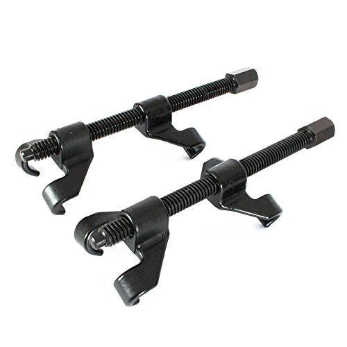

Reverse them to create coil-sping extenders.
those would be nice if I could get them....might be too big to fit though?

Use the rubber spacers...they're cheap...as long as they fit. You likely have Mcphereson strut front end, which has the spring attached to the shock/strut. Even if you drop the strut, the spring won't extend any further.
