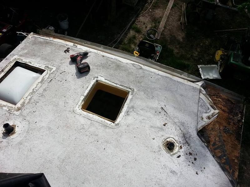

Working on a camper roof
Old 03-09-16, 11:06 AM
cheese's Avatar
Join Date: Jul 2001
Posts: 15,794
Received 110 Upvotes on 100 Posts
I just got a 2000 model hornet camper 21 feet long. The only thing wrong with it is some bad places in the roof. I am about to open it up and see what needs to be done. Does anyone here have experience working on camper roofs?

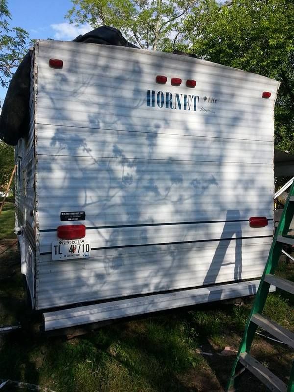

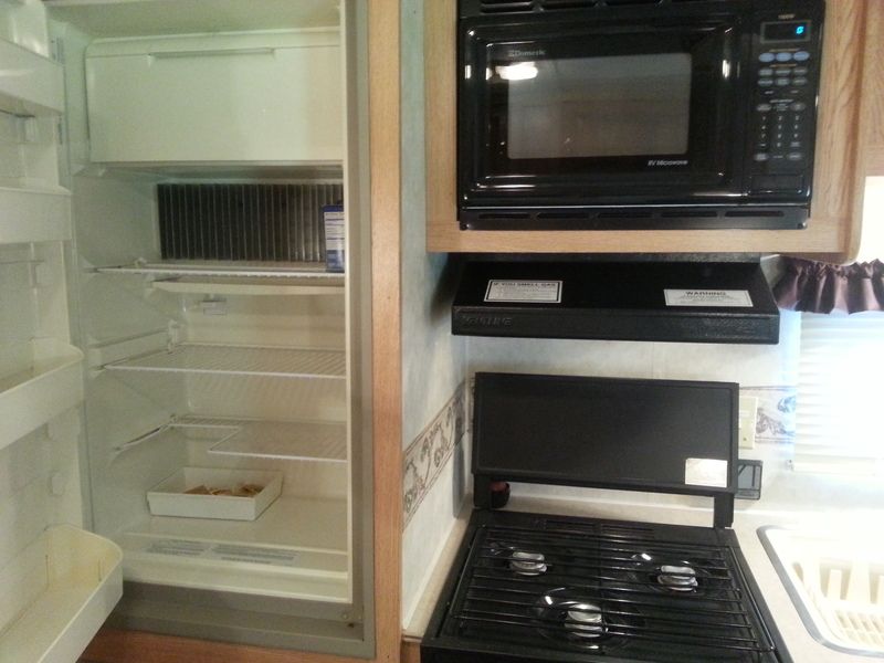

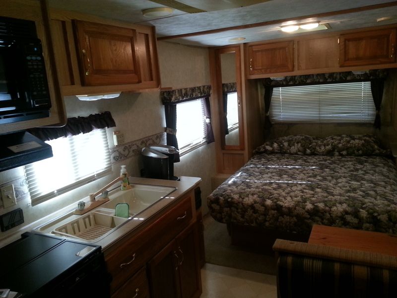

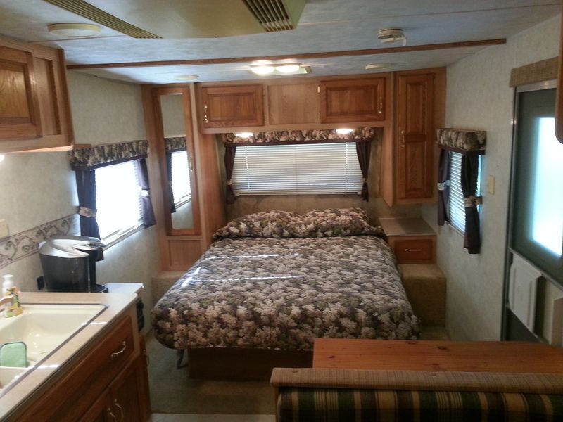

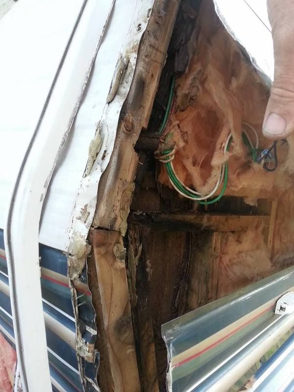

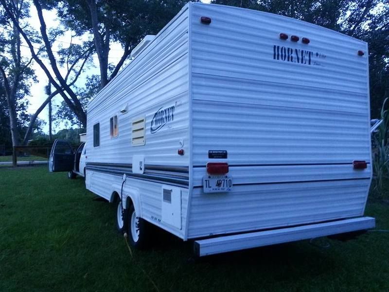

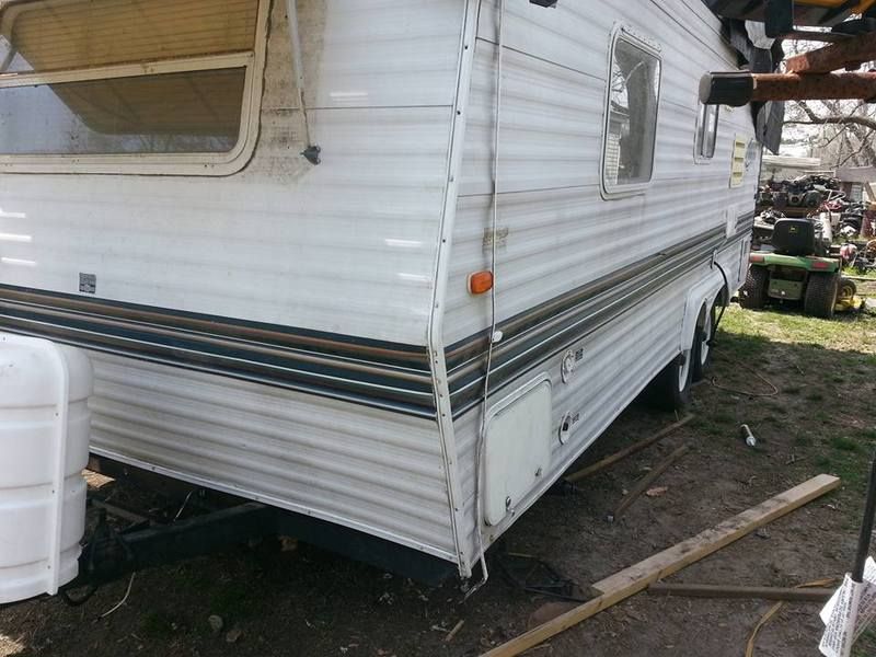

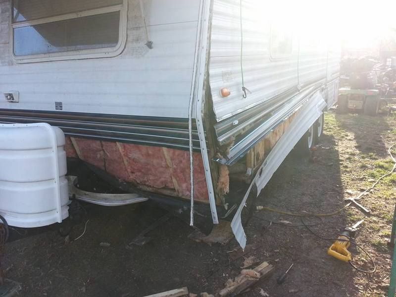

I took the siding off in a few places to check out and repair some rot from the leakiong roof. I haven't gotten to the roof itself yet though. There was some damage but nothing I couldn't fix. This thing is basically new (it was bought when a storm damaged a home and the folks lived in the camper while it got fixed). Then the camper just sat, and sat. It's worth the work and if I do it myself, I know what I have and that it was repaired well. I'm planning on the liquid roof too, but I have to pull up the rubber in a few spots to fix the lauan or whatever is supposed to be under it. It feels like the truss spans are solid, so hopefully it won't involve much.
The people I got it from knew it hadn't been maintained and there was some damage, so they let it go super cheap. I only gave $500 for it!
Attachment 64213

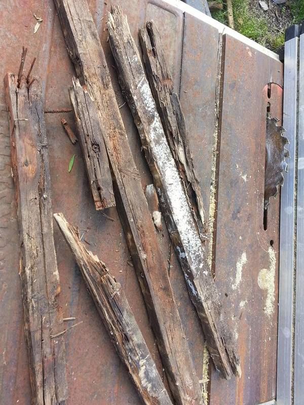

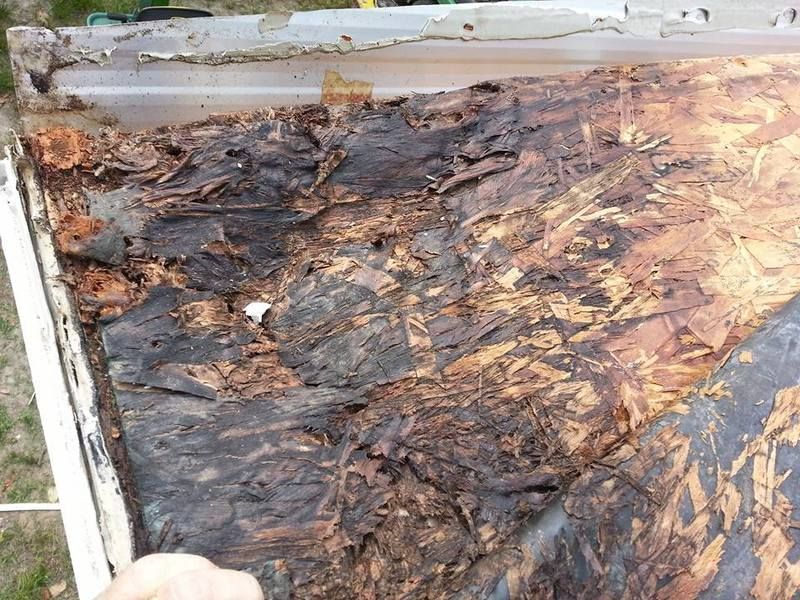

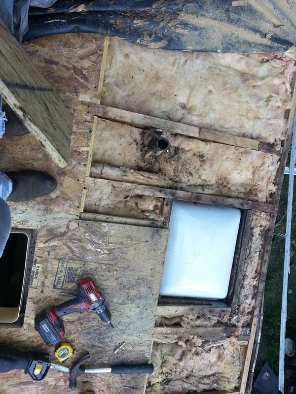

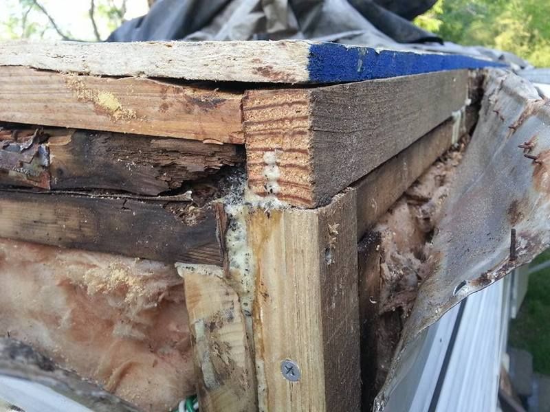

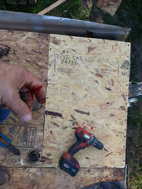

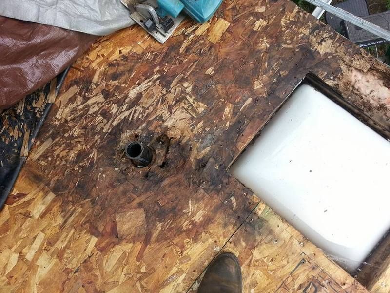

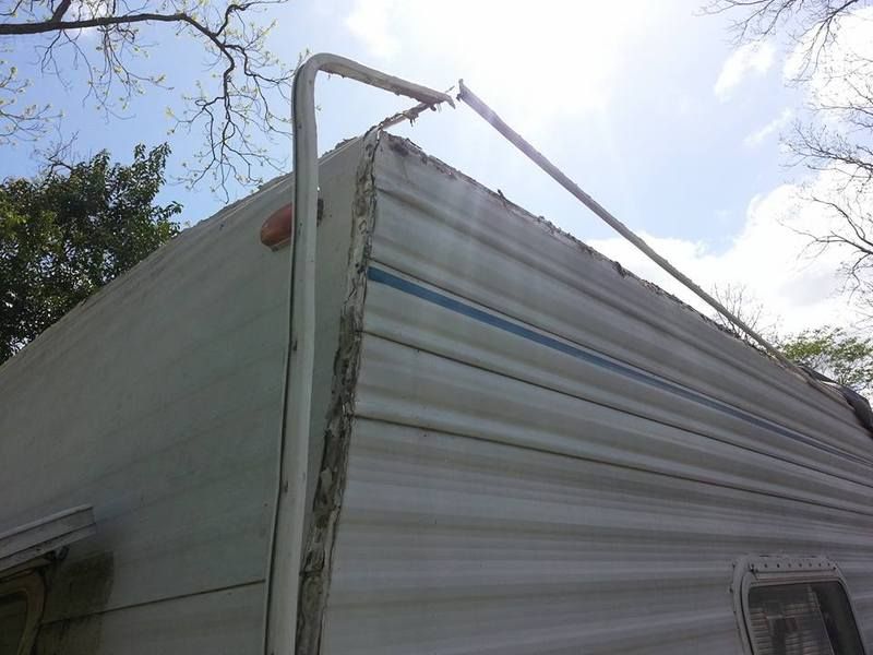

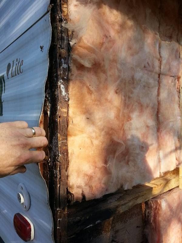

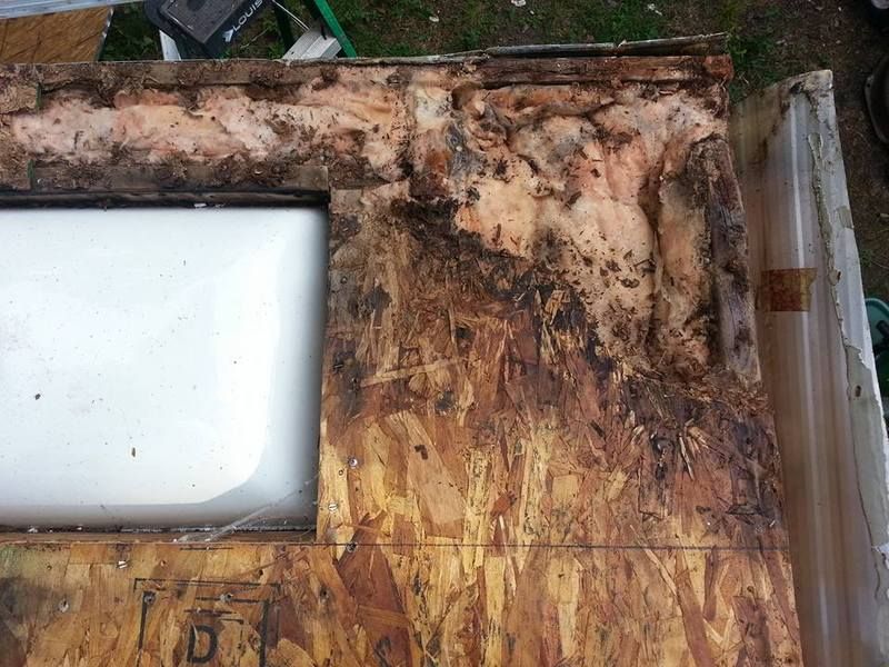

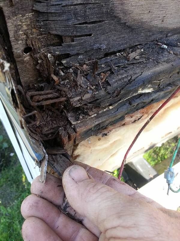

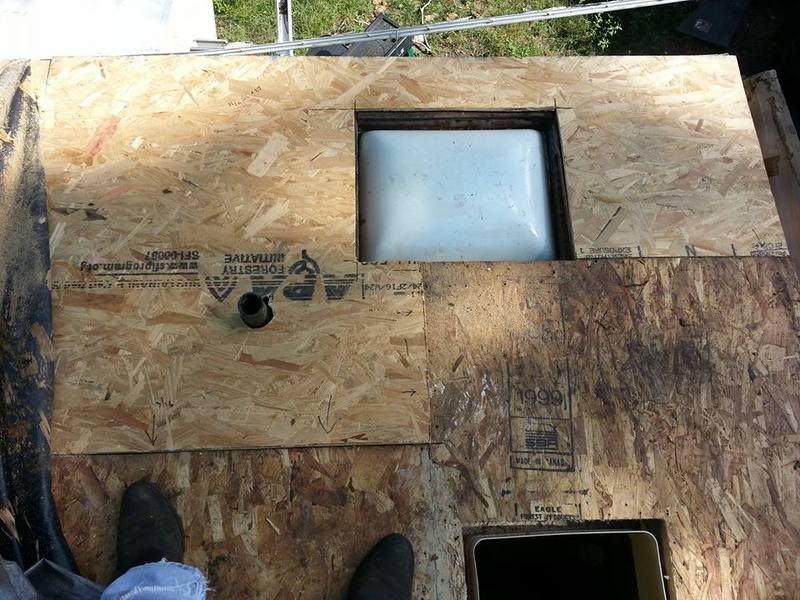

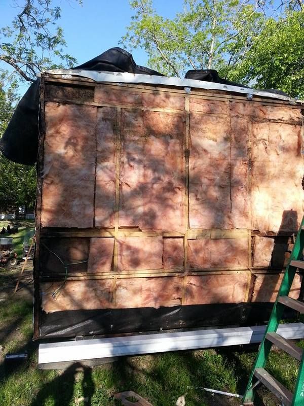

Thought I'd share. I didn't take pics of everything I did or every step, but here it is from start to finish in a few posts:
This is the front left corner of the roof, from taking the trim off to ripping out the rot, trimming back to the good wood, making ends for the trusses, notches for the wiring, framing up the bad areas and putting the wood back on. Also removing the vent/skylight to replace it with a new tinted one.
Old 08-16-16, 11:41 PM
cheese's Avatar
Join Date: Jul 2001
Posts: 15,794

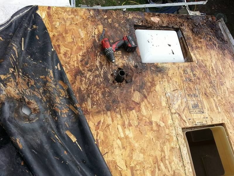

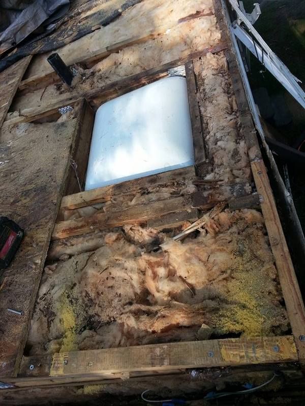

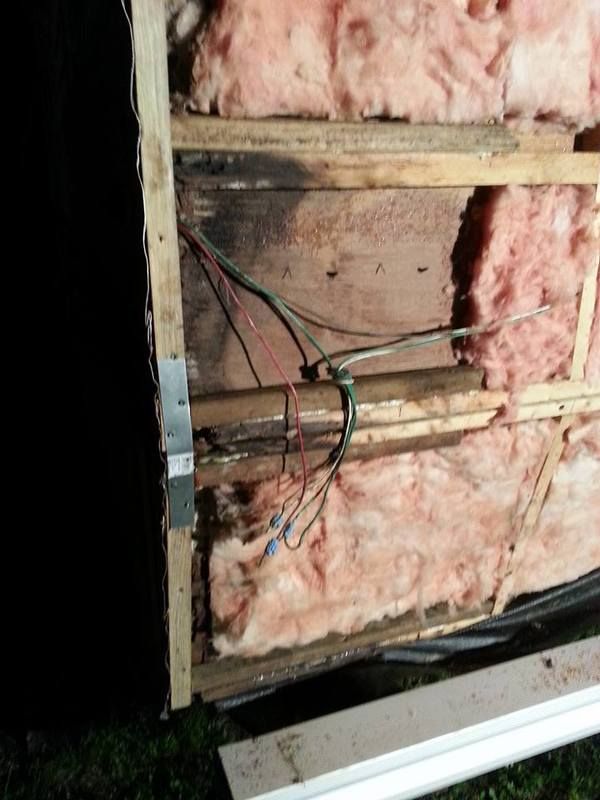

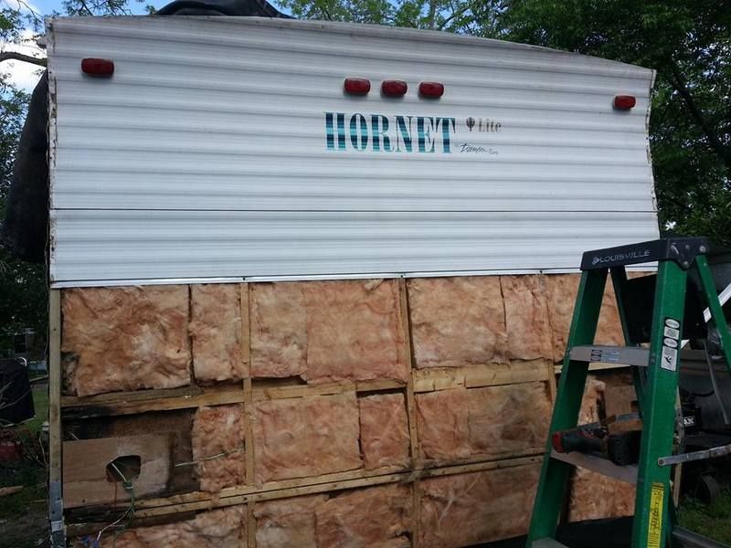

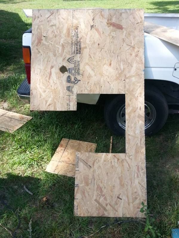

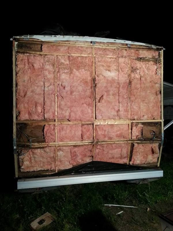

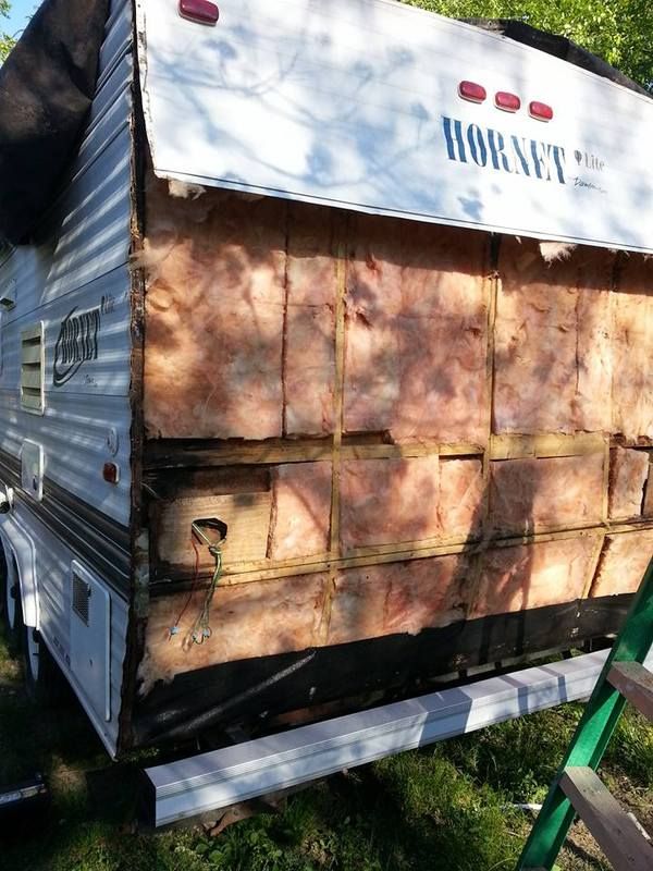

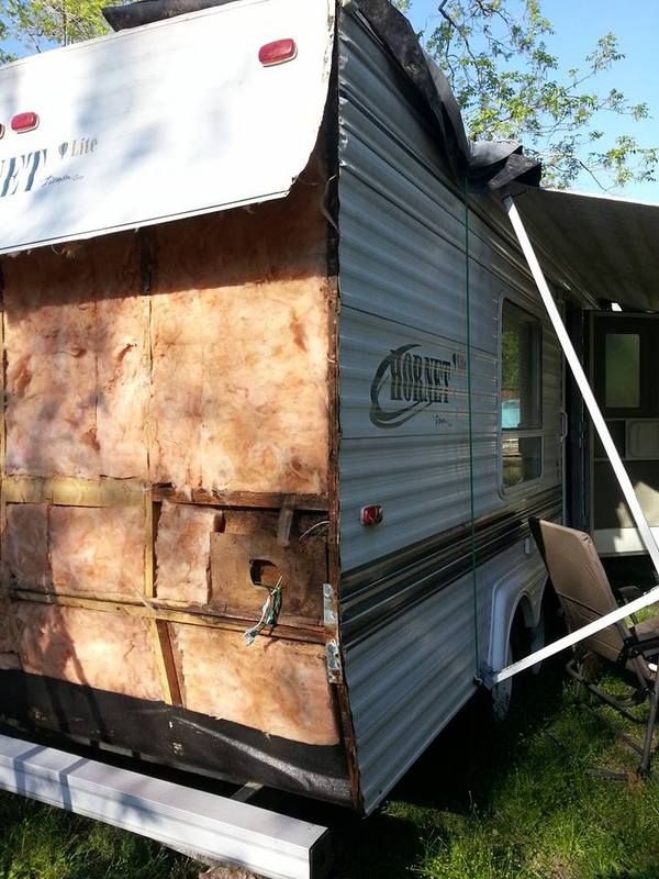

Next is the back end... I was able to push on it and feel the framework move, so I knew it needed to come off. Pics start with the metal siding coming off, showing rot, repairs made, bracing and the siding going back on.

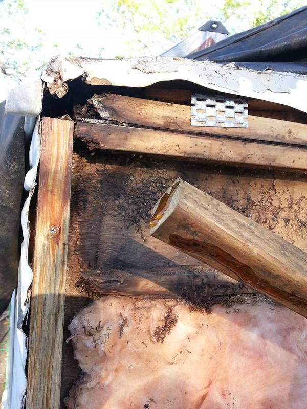

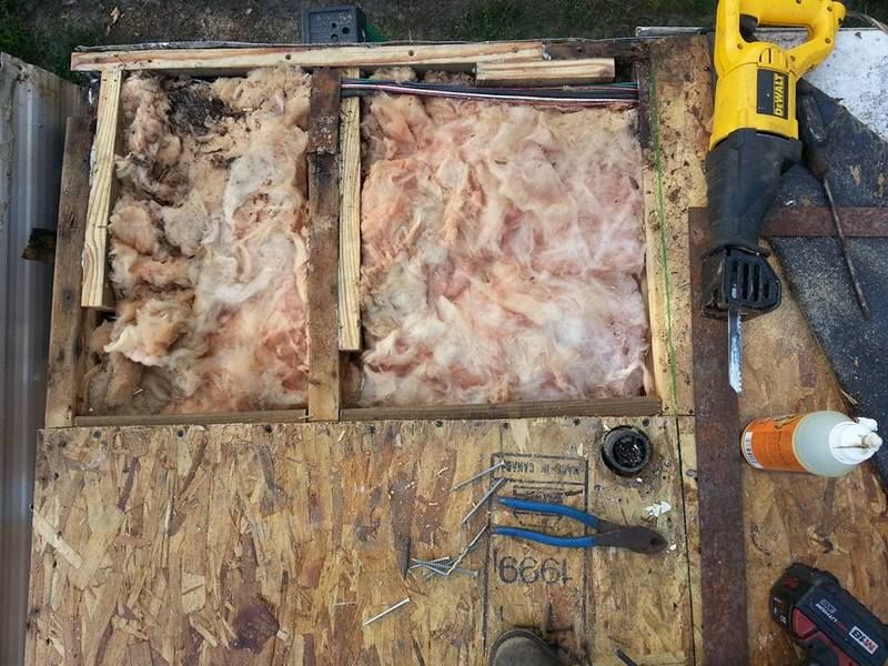

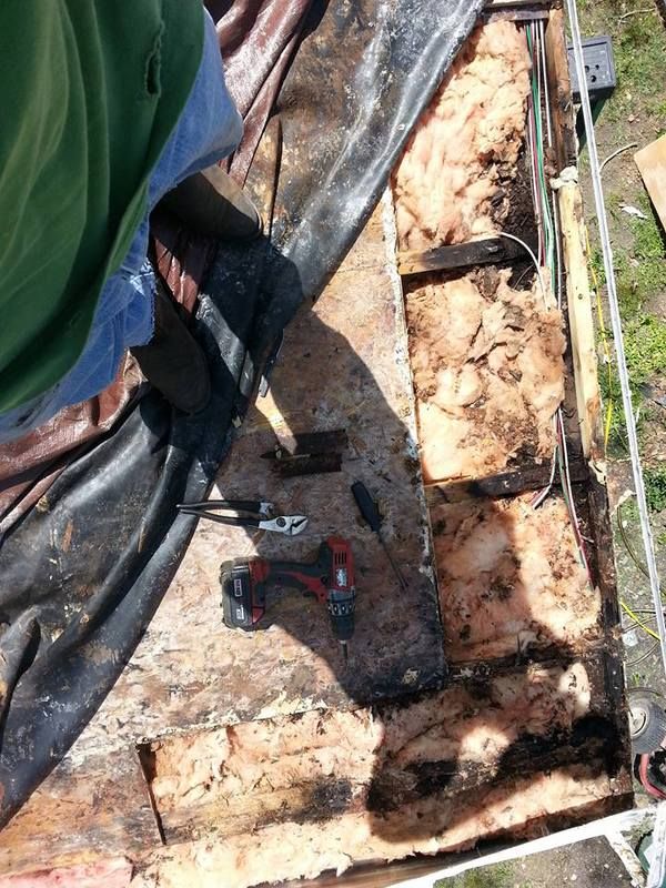

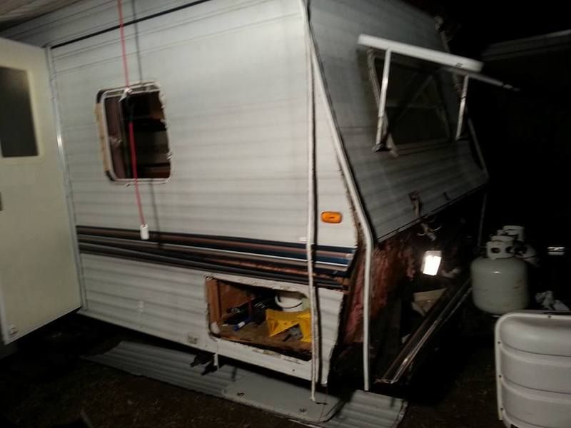

Next is the left rear roof corner, from discovery of the problem to repaired:

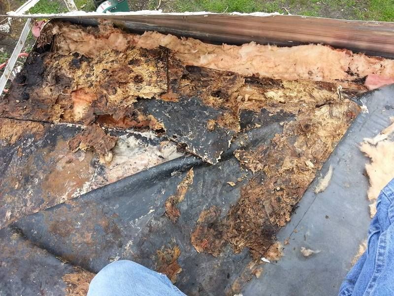

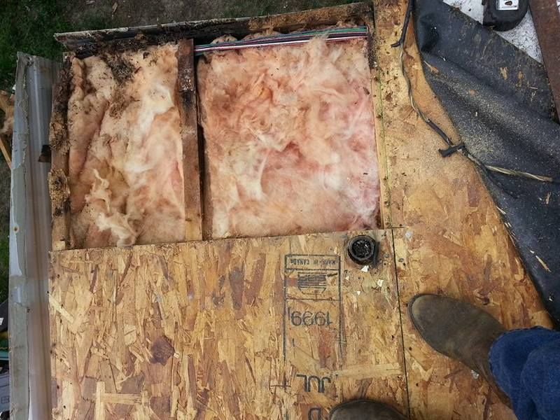

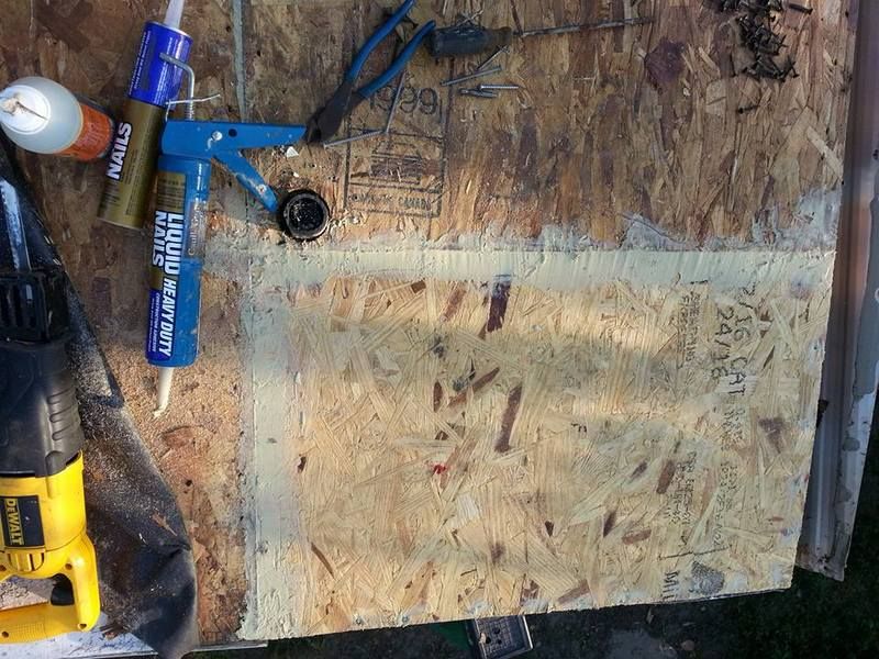

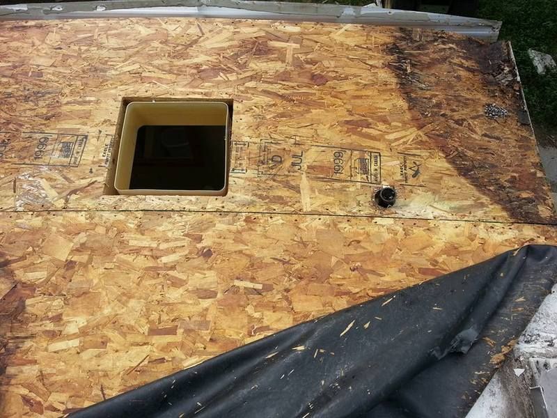

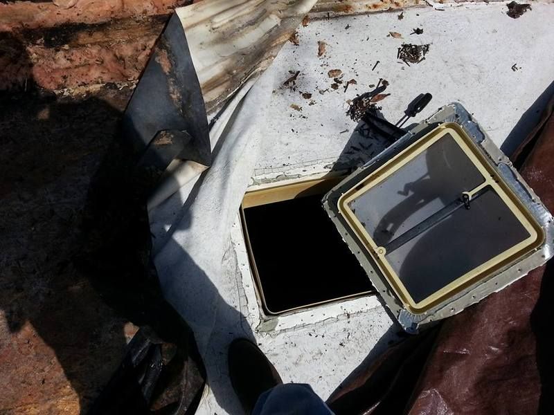

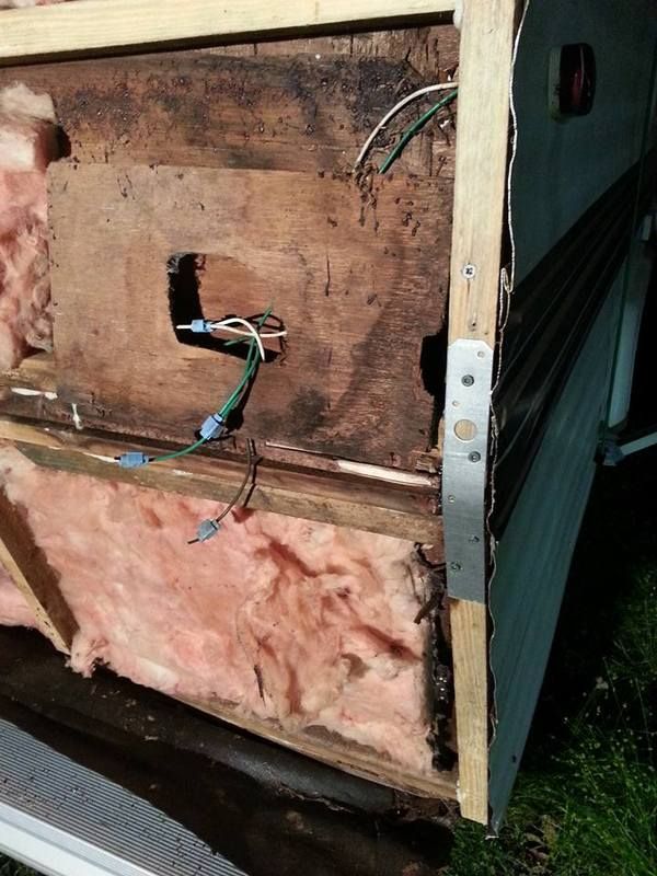

Then comes the worst part, the right rear corner of the roof. This shows the problem, tearing it out and repairing, the new puzzle piece to go back on, and the finished repair.

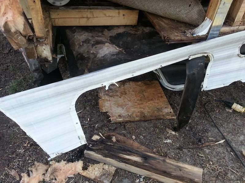

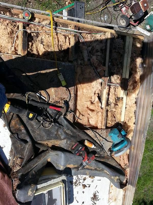

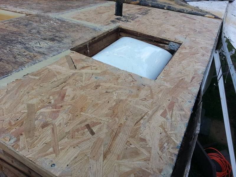

And then the front needed work too, some bad framework there. I didn't get much in the way of pictures there.

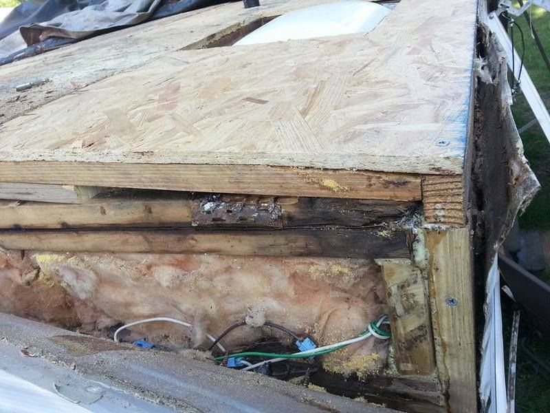

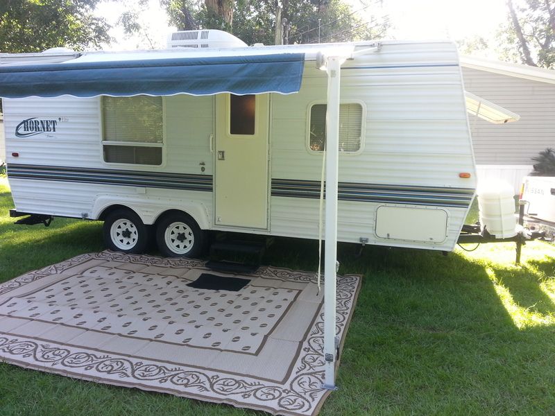

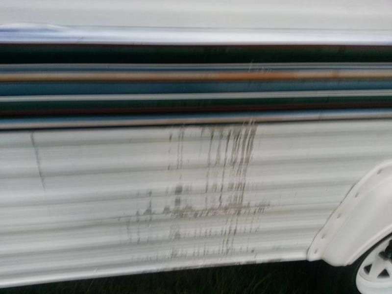

Then while washing it, I found places where the paint had deteriorated from something dripping off the roof all down one side, so I had to do some painting. I'm pretty pleased with the final results, you can barely tell where I painted even if I point it out. On the roof I have new tinted skylight vents, new fridge vent, new plumbing vents, and new inner and outer skylight over the shower. I used contact cement to glue the EPDM rubber back over the roof (it was still good) and I used plenty of Dicor lap sealant and mastic tape. The exposed screws are now stainless steel, and I put new trim tape over the screw channels on the corners. The framing repairs were made using longleaf pine for strength, screws and gorilla glue between the clamped pieces. Steel brackets for reinforcement were used in the front and back too. The new tires just got put on days ago. I also painted the underside with flat black to freshen it up. The camper looks like new and we are happy! Hope this is useful to someone else tackling this job. I don't browse this forum often, so if anyone has a question, feel free to PM me. I'll be glad to help if I can.

That was an incredible amount of work. My parents have always had campers and motorhomes so I know first hand how much upkeep they need.
Nice job.

Thanks! It was indeed a lot of work, more than I was prepared for, but I had already sold our popup camper because we got this one and I was going to use the money from it's sale to fix this one... so I was committed. Not counting labor, I have around $2500 in this one now, and a large part of that is in the new liquid EPDM rubber to coat the roof with when I get around to it. The old roof is in better shape than I thought, so I'm not in a big hurry to coat it with the liquid right now.

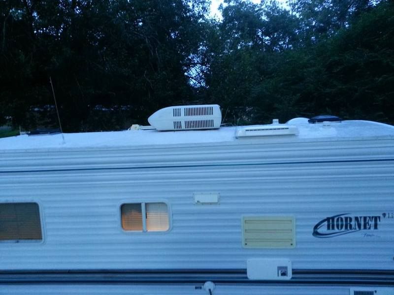

Here is how it came out..
front 1/4.. I leaned on the roof vent and it cracked.. I put liquid roof on the crack until I replace it...

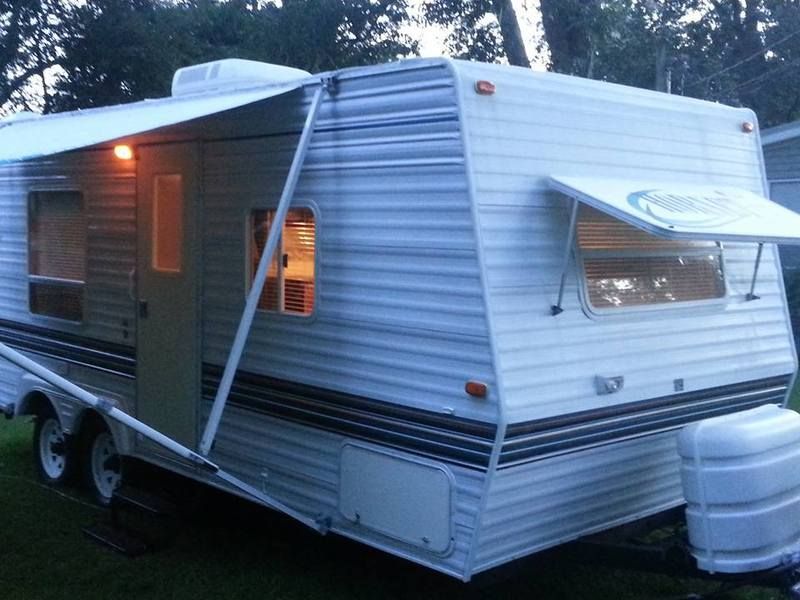

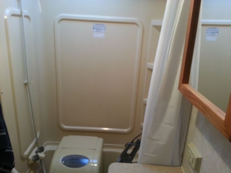

I took it out this past weekend and it worked out great! Everything works except sometimes the microwave decides that none of the buttons are going to work, and then it goes back to working fine. Not a major problem. The water heater pressure valve leaked some but I tapped on it a little to seat it and it stopped.
On the way out, I stopped by the wasted dump station and let the water out and according to the tank level readout, all the grey water drained but it says the toilet water tank is still 3/4 full, but I pulled the valve and let it drain until it stopped running. It didn't run long... not sure if something is clogged or what. Do they clog often? I've never done this, so it's all new to me.
  #32
Old 08-29-16, 03:47 AM
M
Join Date: Mar 2005
Location: USA - N.E.Tn
Posts: 45,151
Received 738 Upvotes on 645 Posts
I've never worked on a holding tank but I'd bet the float on the sending unit is stuck.
Can you peck on the tank to hear if it sounds empty?
  #33
Old 08-29-16, 06:37 AM
W
Join Date: Feb 2006
Posts: 6,345
Received 60 Upvotes on 52 Posts
The waste tank has a sensor at each level shown on the monitor. The sensors accumulate waste and do not come clean when the waste tank is drained. The monitor thinks the the tank is full when it is in fact empty. Dump two bags of ice into the toilet and flush as you start on the road. The ice should dislodge the waste from the sensors. Hope this helps. Good luck with your camper. It looks really nice.
Edit: I found this at Wally World:
https://www.walmart.com/ip/Camco-Hol...ingMethod=p13n
The wand is inserted into the black water tank through the commode.
