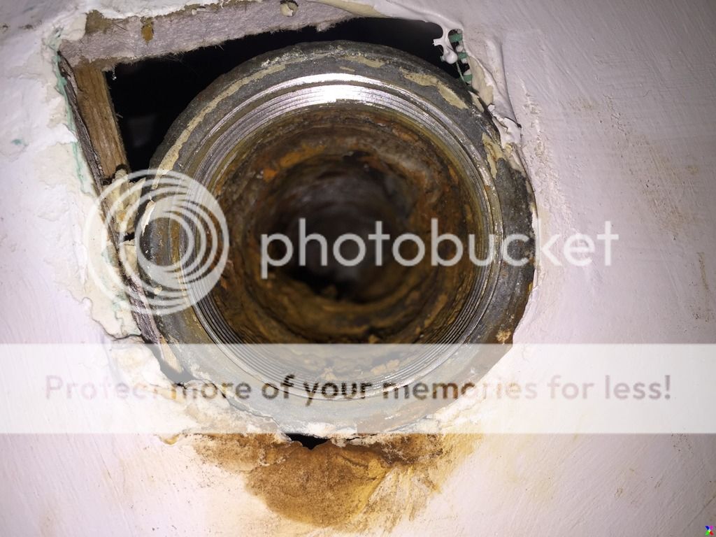

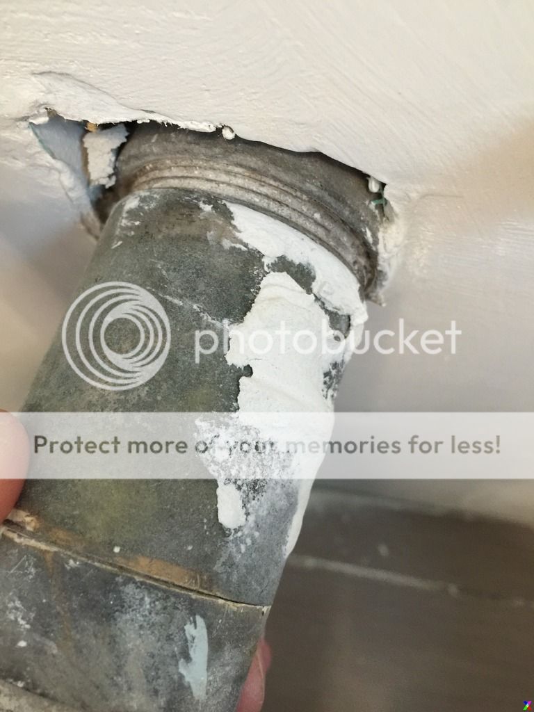

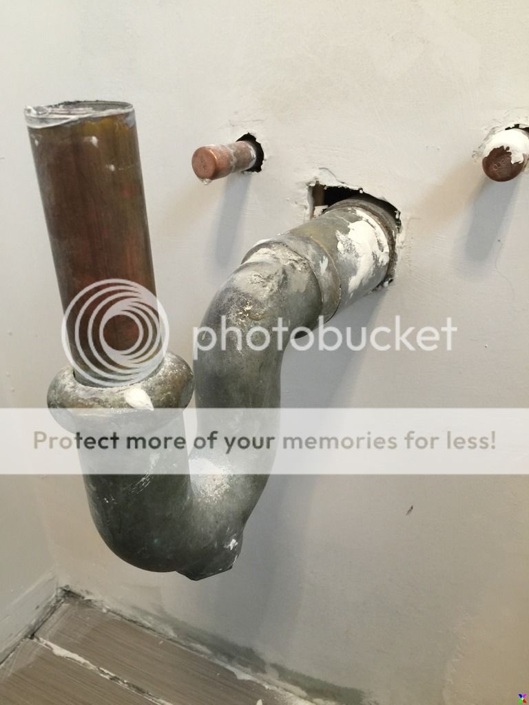

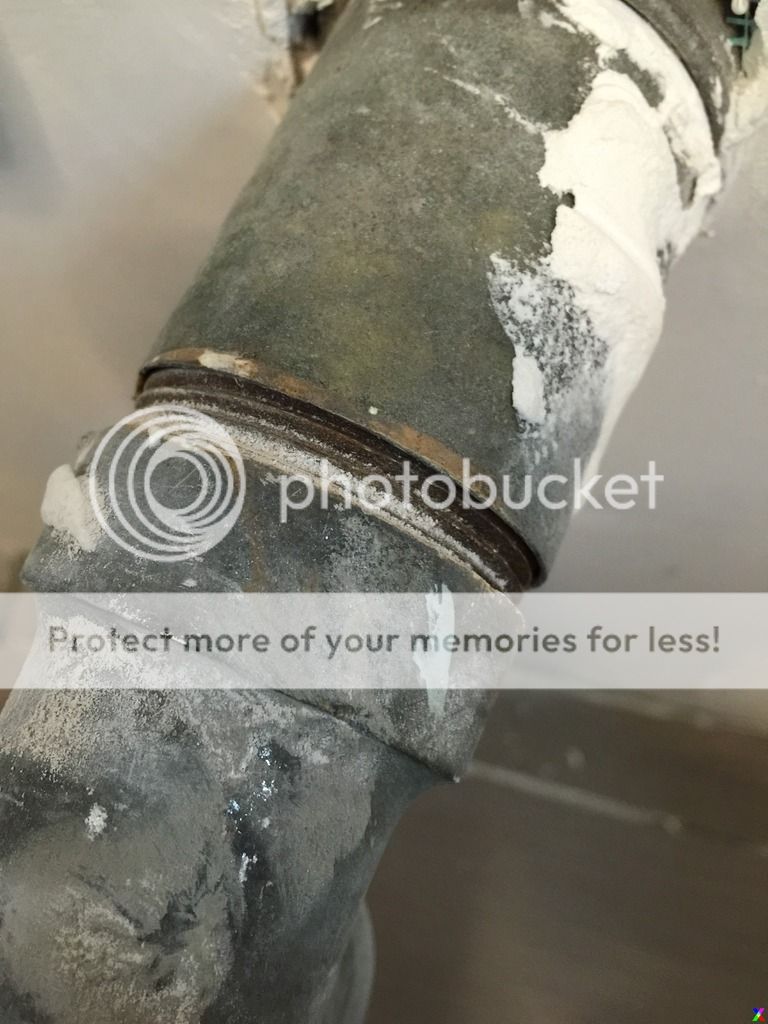

I am replacing a sink with a larger one and need to replace the existing brass trap with PVC so I can adjust where the drain is lined up.
I'm not sure how to remove it though. The entire trap appears to be threaded on to a short galvanized nipple with that same nipple threaded in the galvanized waste pipe into the wall. Most of the threads are covered by a loose metal collar that can slide back and forth.
My first thought is to get a cheater bar stuck down the trap or a wrench and twist it off but that could also loosen the threads of the nipple into the waste pipe. The nipple appears to be in good condition from what I can see (no apparent damage where the two metals meet).
Can anyone tell me the proper way to remove this and replace with pvc? Or is there another method I should use? Can I remove the entire nipple and replace with a piece of threaded PVC (The waste pipe is flush with the wall)?
I have included some pics below:
Need to replace
Nipple threads on p-trap side
Nipple threads on wall side (note the metal collar slides back and forth):
Thanks!

Just unscrew it. Doubtful the nipple will unscrew, but if it does, just screw a slightly longer nipple back in after you've removed the trap. Using a long nipple will give you room for a wrench. Then you can screw in a Trap adaptor with male threads.
I too would just unscrew it. Something will give either the trap or the nipple. Either way it doesn't really matter since you can just put a new nipple in if you need to. You may just be able to use a threaded PVC adapter and screw that on and not need a nipple.
I wouldn't try to remove the nipple from the tee in wall.
I would cut the trap off using a reciprocating saw and connect the new trap using a shielded no-hub coupler.
The 1-1/2" no-hub will connect the cut off pipe to an adapter, which can be ABS, PVC, or a trap adapter for using slip tube PVC fittings.

Remove the steel nipple. It may take as big as a 24 inch wrench. If you still can't get it out then cut it as close to the wall as possible and then use a cold chisel and a big hammer to collapse it and then remove it from the sanitary tee.
Buy a brass trap adapter, slather the threads with Rectorseal or Teflon paste and screw it into the sanitary tee tightly. Then use PVC drain tubing and trap. Done.

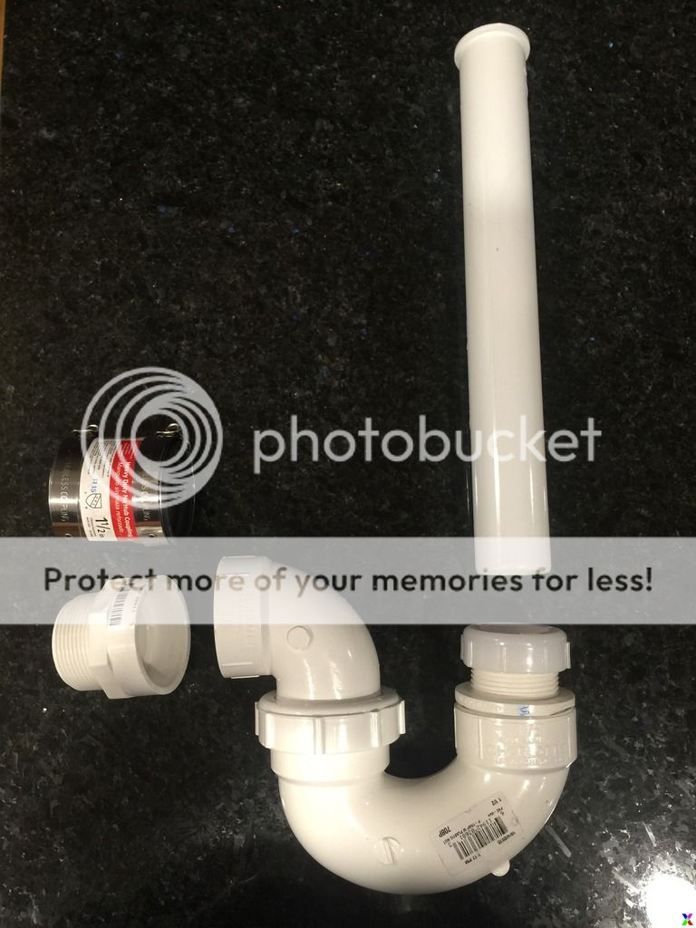

I went to the box store and picked up some parts. The no hub is if I can't get the nipple out. Otherwise I'm going to go with the pvc adapter.
The bagged all in one assemblies for the p-trap were cheap feeling so I would like to use 1 1/2" pvc (i think its schedule 40) for the entire piping except for the tail piece. The one in the pic is 1 1/2" but I'll get a 1 1/4". I also have a few elbows if needed to direct the pipe if necessary.
Couple questions:
1) Any issue with this setup?
2) Assuming I can use the PVC adapter, do I use Teflon tape or pipe dope? Both? Neither?

The set up you show is good. You only need a short piece of PVC pipe to connect the adapter to the trap. Purchase a 12" piece and you can cut it to length.
For the adapter threads I would apply both tape and Teflon paste. You might only get a few turns on the adapter, which is good enough and the paste helps a lot.
The 1-1/4" tailpiece adapter I would make higher if possible, an adapter connected to the trap with a short section of pipe.

I got the nipple out! That sucker was in there tight. I used the regular ~12" wrench and my back is going to regret it.
I feel like I need a tetanus shot with all the gunk in there but the threads are shiney and seem to be in good shape.
I poked out some of the easy stuff with a screw driver for a few minutes and got this, I'm happy with it:
I'm amazed the previous sink drained.
Interestingly, it does not appear to be a tee. Rather it seems that another pipe is connected and goes strait down after an angle. I'll go in the crawl space to see if it's worth cutting out the whole thing for PVC but I feel I should just leave it alone.
