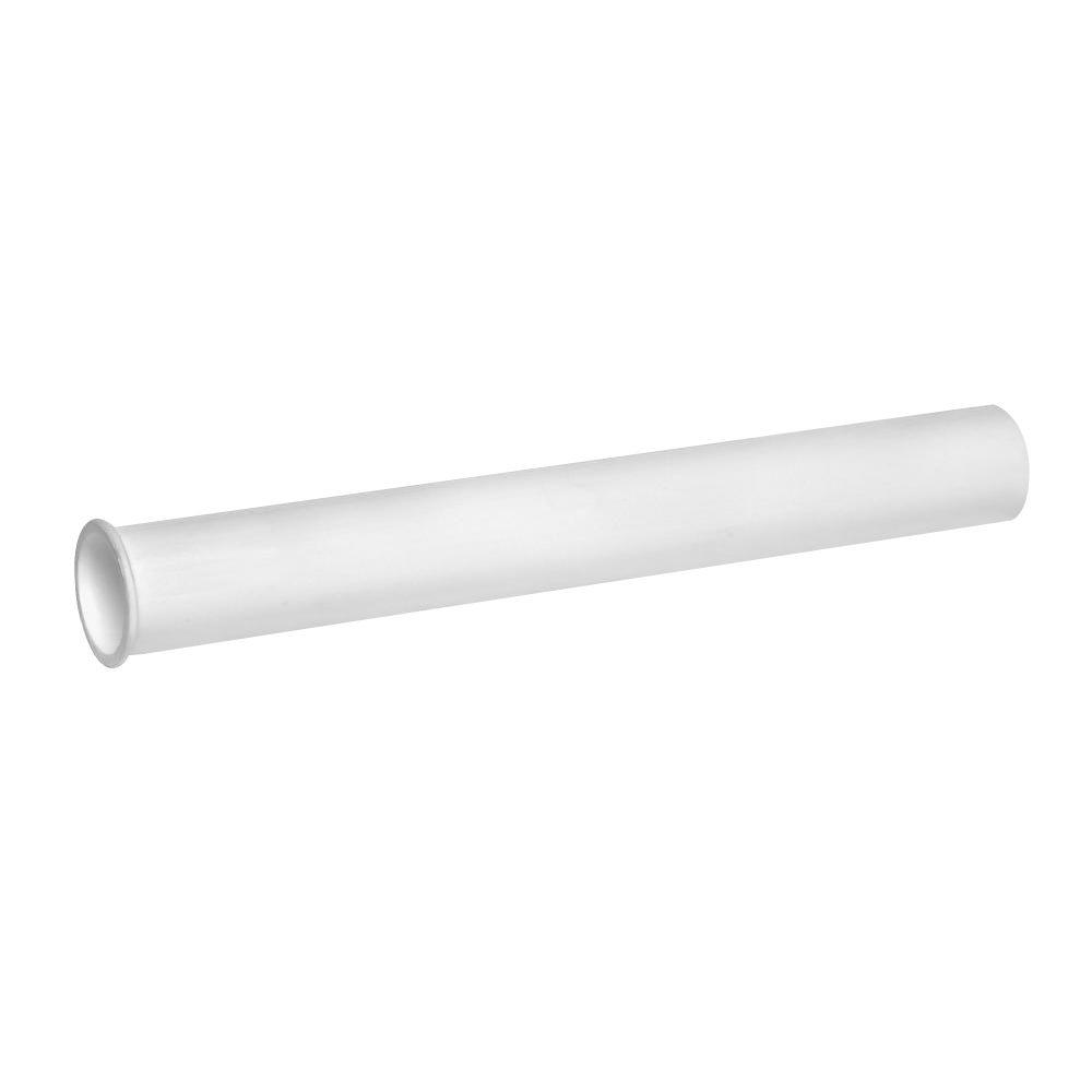

Straight tail piece.. The tailpiece is held on with the metal adapter mount at the GD end...... It aint coming off...
The tailpiece has a hat on one end,,,

See the metal adapter on the GD? You slip the tail piece through it....

The top piece coming off the top of your tee should also be a tail piece and not the tail piece adapter as you show...
