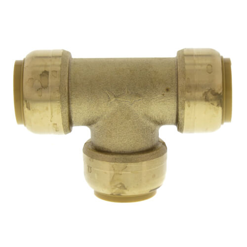

However, if I run the main line to the fridge with a shutoff at the floor, would I use a sharkbite tee like the one below on the main line. Then connect a piece of PEX or CPVC to the tee and attache that to the wall (or piece of attached wood) to secure it. My only thoughts about this is there's no shut off at the main line like the one above, and if something were to happen from the main line to the connection at the fridge I'd have to shut off my main water supply to fix it (unlike the built in shut off in my original idea).
