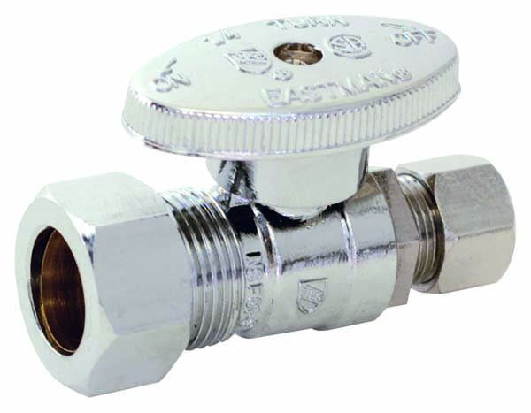

Not to imply that you haven't been thorough, but every claw foot tub I've seen has angles stops - usually 1/2" - above the floor behind it. What's behind the tub? Just copper connecting to the faucet?

steve_gro. It's not a "claw foot tub" unless someone tiled up around it. What's an ANGLE STOP?

Here's what an angle stop (it's a little valve) looks like (this is actually a straight-stop):
