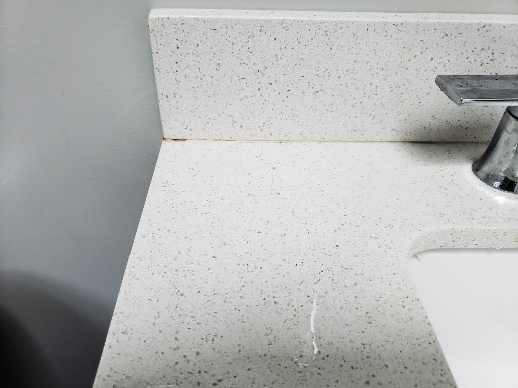

Hi All,
Is the backsplash for a vanity supposed to be somehow adhered/sealed to the countertop so that water does not get inbetween? I'm attaching two images, one a close-up showing where I mean circled in red, and the other is a distance shot to provide perspective.
We keep getting yellow gunk in the crack - should it be sealed? Can I seal it now?
Thanks!

The backsplash should be attached with adhesive to both the vanity top and the wall or, if that's a problem, at least the vanity top. To avoid the issues you described caulk should be set in the corner and where the top of the backsplash meets the wall. These are two separate but important steps.
With a solid surface material top it is quite common for the back splash to be shipped loose to be installed in the field. What the installer didn't do was complete the installation by caulking the seam. I would use a color coordinated silicone caulk.
Although I agree that the gap should be caulked I would use the newer siliconized latex caulk with microban, they are a much newer and better caulk for bathroom applications!
My marble installer guy said he doesn't caulk the backsplash to top crack. I took his advice but have to clean that crack occasionally. He said he finds that better than removing caulk when it discolors or gets damaged a few months later.
The backsplash is typically attached to the wall and separate from the vanity top because of the possibility of movement between the two. However, the joint between the backsplash and the top should be sealed with a good, mold resistant silicone caulk.
My experience is that the smaller the caulk bead, the less chance that it will turn moldy. I used a 1/16" gap and a very narrow caulk bead and never had a problem. Wipe the caulk so that there is little exposed outside the gap.
It should have been sealed when it was installed. Now that it is finished I would tape off both surfaces completely with masking tape so that just the crack is exposed, then cut the finest tip you can on the tube of silicone (i'd use a clear 100% bathroom silicone which is mold resistant) and inject that into the crack. Then spritz it with isopropyl alcohol in a spray bottle and scrape off all the excess with a plastic scraper... forcing the silicone back into the crack as you tool it. Dont get silicone on any other part of the countertop... be sure its protected with masking tape.

Before starting, clean the crack with a tooth brush and isopropyl alcohol.
Also before you cut the tip do a practice run along the seam. This will help you figure out how to calk it smoothly.

On small beads like this I do not use tape just a nice bead, let it set up a bit ( get a bit of a skin) then run a wet finger over it to smooth it out a bit. Spit or water and dish soap work.
Buy a good bathroom silicone not this new environmentally friendly crap just because it is crap.

Thanks for all the advice. I had some clear siliconized caulk on hand, so that's what I used - it came out great! I now have 2 more questions (1 related, 1 unrelated):
1. Related - What's the consensus on whether I should seal the top of the backsplash to the wall? I can use the same clear siliconized caulk, if people think it should be sealed to the wall. (And then I guess, should I seal the sides of the backsplash to the wall? I'm thinking no on that .)

Assuming the cabinet is mounted to the wall I always caulk the top and edges [when applicable] with a latex caulk which I'll paint with the wall paint. If you were to use silicone - paint won't adhere.

I wanted to revisit this post because after I caulked the seam between backsplash and sink, its coming undone. I'm attaching a picture of it - does anyone have any suggestions as to what I should do?

I'd suggest you reread all the previous advice over again rather than making us repeat it.
What kind of caulk did you use on the backsplash?

I don't quite understand what you mean. Of course I re-read everything before I posted my newest one today - I just didn't (and don't) see anything that discusses how to remove the old stuff which is not sticking and then whether I would need to do anything different than last time in order to put new caulk down. Also, as in my last post, I used "clear siliconized caulk."

The problem is likely that you are using a "siliconized" caulk instead of 100% mold resistant kitchen and bath silicone.
Ok, I can get 100% pure silicone. How do I remove the old stuff?

With a razor scraper. I think all the advice given in the previous posts applies equally well to your other question. Remove old caulk, clean, install new.
