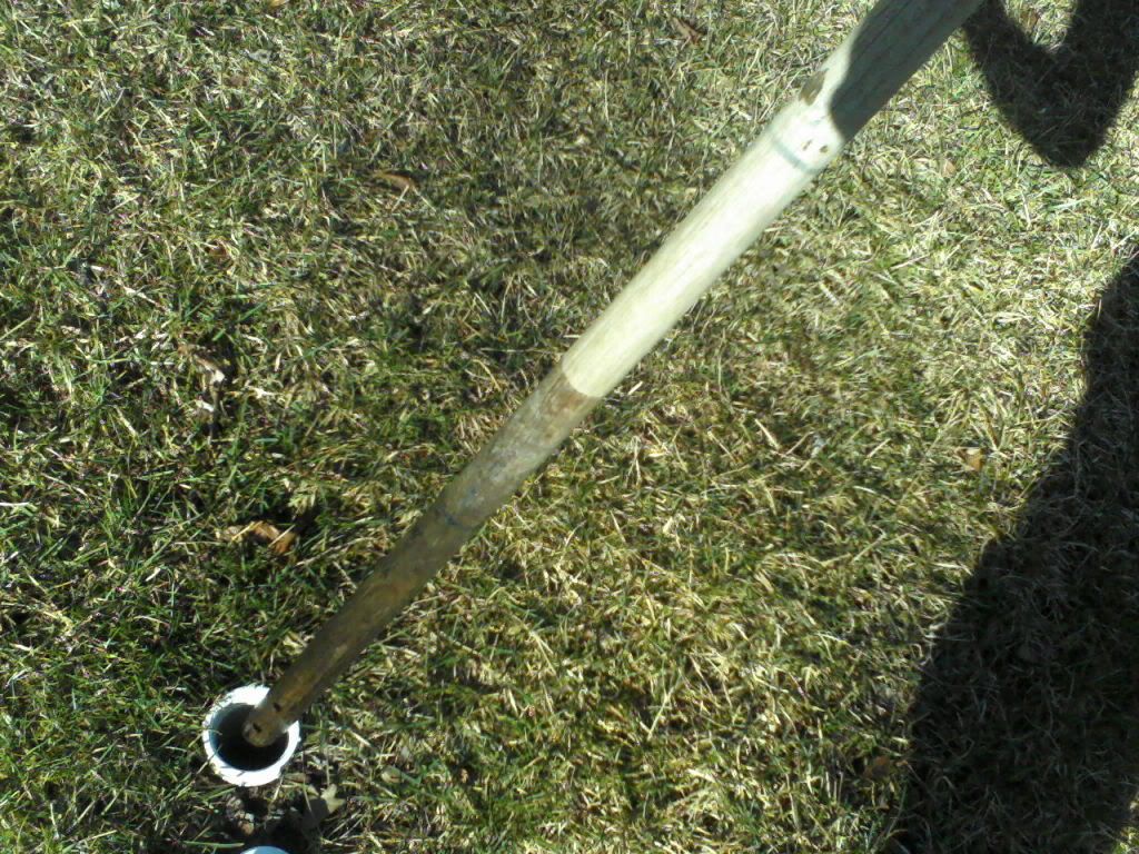

My survey says I have 3 seepage pits. I just found out Saturday, while looking for the D box, that there is only one seepage pit. ( Its as big as the septic but shallow and has holes in the sides )
The pit was full of water, but has since drained down to 4-6". While probing the bottom with a shovel it seemed there is a hard crust. I dug some up and its black sludge.

Im a plumber but not a septic pro. A 10 yr old pit should still be able to absorb water. The rocks around the tank are kind of black.
I will take pics tomorrow.

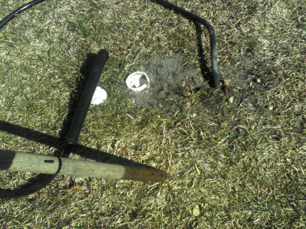

OK Covered the hole to the septic. Thats the spot between the two PVC ports. Did I do good putting the grass back?
Also the trench I dug looking for a D box is covered. Looks like there was not a hole there.
No D box, but the line just goes to this seepage pit. I did not get the bottom sucked out because all the septic companys wanted a full $180 to do it.
Its been a week and all the water drained. It was full. You can see the water line in the pic.

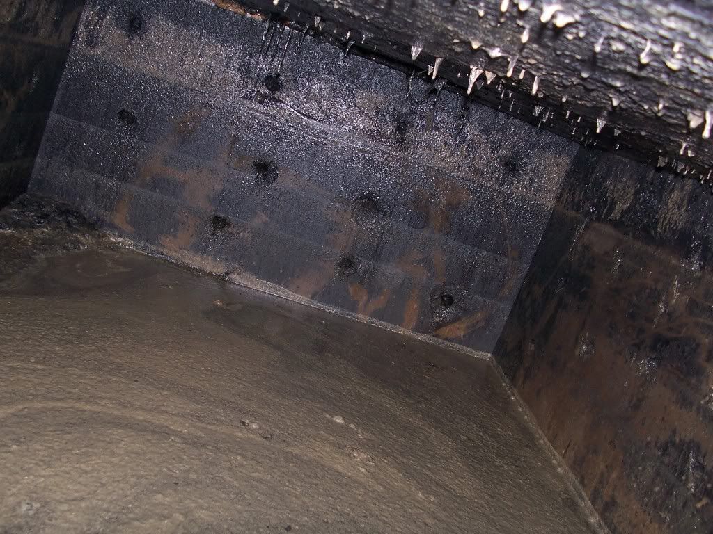

This stuff I got from the home store actually ate the bottom layer of sludge. Look in the pics I posted where it shows the bottom of the tank. Half is brown and half is black. The black part I could not reach to treat.
It was $20 so must be good. Cost alot right???...LOL

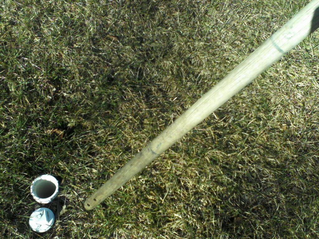

Just incase someone needs to know if these products work. I still have the pit cover open and am going to monitor the levels.
Mike NJ

Anyway here was the tank empty. I used cess flo and thats why half is brown and the other half is black. Thats the part I could not reach.
Here it is filled with 3 days of water. About 3" or so.
I added another cess flo. I want to see if it will eat that layer of sludge in the back of the tank since its covered with water. It started churning and bubbling real good. You could see the brown color throughout the top.
Hey whatever it is doing it seem to work at eating the sludge. I will take pics tomorrow to see what the level is and if this stuff did anything.

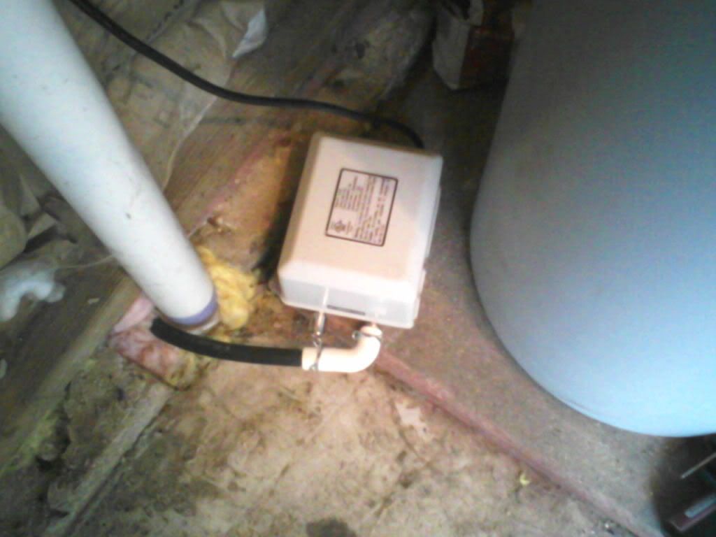

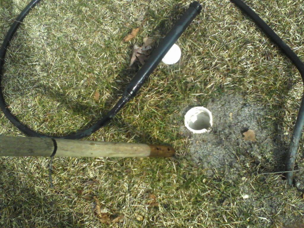

Old 01-31-12, 06:08 PM
lawrosa's Avatar
Super Moderator
Join Date: Dec 2010
Posts: 18,142
Received 60 Votes on 52 Posts
Ok.

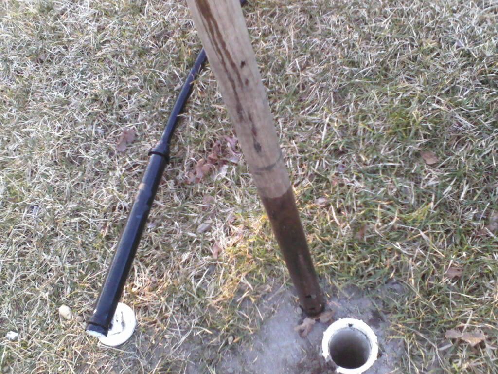

Dipped the seepage pit. Its 6" from the top. This is when I would normally have my friend from the mobile RV place come and pump it some.
Doing this for a yr seemed to keep it at this level and possible restored the top layer, buy there has to be a lot of biomat in there.

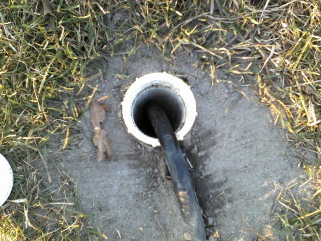

So pump came, hose, air stick, and I buried the hose, cut a notch in my clean out and installed the aearator.
This cost me $180. I also bought some cess flo aerobic stuff from the home store to help get it going.
I have pics of the starting level. I will be dipping once a week and posting on mondays if I can.
We are family of 5 using everything normally.

Here is the septic. In and out service ports. Lid is 21" down in the middle. I dont mind digging every three yrs.

Getting ready to dip. Marks are at 1 ft on stick. They are abit faded.
Stick is 5 ft and goes to bottom of tank.
At the 2ft mark it will be at the top of the inlet to the pit.
[IMG][/IMG]
Dipped.
[IMG][/IMG]
If I leave it alone the level will rise higher then the inlet. This is why I have been pumping it off before it reaches that level. This is also why I am trying aeration. I tried all the chemicals and nothing worked. Save your money. Cess flo is the only thing I saw results with that is in expensive. Aid ox had results in the begining but it was temperary.

OK week one. I have installed the aerator pump in my seepage pit and see fabulous results. Wow in just one week also. You could believe me or not it dont matter but I can say that whatever its doing it has reduced theseepage pit level in half.
Just went out and pulled the areator to dip the tank.
Here are the pics.
Here is the pump. Its a 25 cfm or liter hakko. It was $130 on line. Ran the hose out and burried it to the clean out.
[IMG][/IMG]
Hose going into clean out.
[IMG][/IMG]
Cap off.
[IMG][/IMG]
Tank dipped. You can see there is less then a ft of effluent in the tank. Previous test last week was at 1.5 ft. But that was an older pic. Before I put the aerator down it was at 1.75 ft. At 2 ft it would be over flowing the inlet.
[IMG][/IMG]
You also see the aerator stick I got with the pump.
I will continue to monitor the results. So far I will be looking at something possibly with more cfm that I can put in the main tank. But I am leary about churning up the solids. I was told my set up offers the best option that I dont have laterals and am able to aerate the effluent directly.
I hope you take my experiemnet seriously and anyone with septic issues with the drain field may want to look into aeration as an alternative.
I will keep you all posted.
I am trying to figure how to pipe that hose into my cleanout that is more permanent that I can remove easy to dip the tank to check the level.
Oh and no smell.
If you read my previous post also you will know that my pit was not draining. I was getting ready to dump a new pit in nect to this one. You will also know that for the past 9 months I was pumping the pit out on occasion when it got too full.
I told the whole family to flush normally and shower as they normally would. It use to be if its yellow let it mellow, brown flush it down. Not no more. I encourage water to be used. the more water the more aeration, and better to eat the biomat IMO.
Whats you guys think?
Mike NJ

I am glad it is working out. Just guessing but pumping in the air and going aerobic should process waste 20x faster than anaerobic so hopefully the pump you have now will be sufficient.

OK ladies and gents.
I checked the tank today on week #2 of my aeration experiment. Its going extremely well in a very short amount of time.
Down to 6" level from almost 2 ft. This would never occur on its own and at this point my tank would have been at the discharge pipe already and I would have called my friend to pump.
I will have to go back in my seepage pit pics and try to determine where I am at. I may not be hitting the holes in the side of the tank any longer and only percing from the bottom of the tank.
Well we will see where I will be at in week #3.
Here are the pics. I darkened the ft marks on my dip stick.
[IMG][/IMG]
[IMG][/IMG]
I encourage anyone with a seeptic with pits, laterals, or whatever.... to invest in an aeration retrofit next time they have their tank pumped.
IMO I dont think you need lots of aeration such as a large electric use pump. ( some are 100 watts plus) The pump I have is only 25L per minute/ 1 cfm
Checked with watt meter and pump is running 22 watts. At my rate this equals $3 a month electric use running 24/7.
See ya next week when I check the levels again.
Mike NJ

FYI this is week 3.
I am down to 3" or so.
I am wondering if its beneficial to keep more water in the tank now that its aerating this well. This is where I am not sure and there is no info on the net out there.
Possibly I will put the 2.5 gpm shower heads back on?
I wonder if its better to have water so the aerobic bacteria will eat more of the biomat at higher levels of the gravel around the pit....?
Or best that its dry and probably will stay dry at the upper levels. It was my assumption the biomat stays a hard crust when dry?
Possibly I can just unplug the pump and see if the pit fills up again. Then plug it back in.
IDK...... Anyway pics below.
Since its so low I will probably do this once a month now. Then possibly check it every three months as time goes on.
I will let you know.
Mike NJ
[IMG][/IMG]
[IMG][/IMG]
