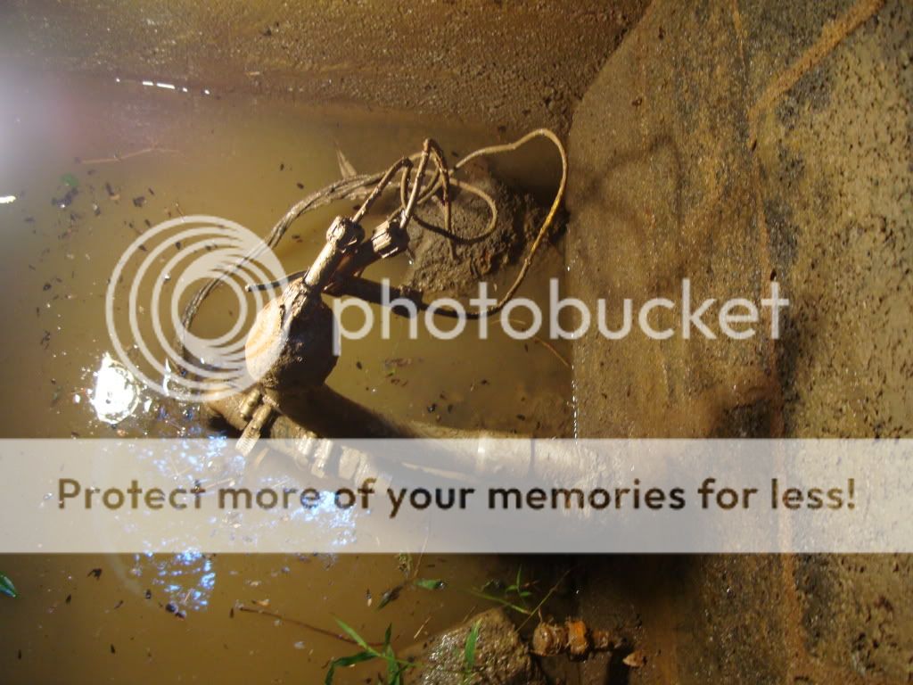

Greetings:
Background:
My parents have a well water pump that is 100í away from the house and approximately 80í into the ground. It is wired into a detached garage and installed 6í underground in a cinderblock walled pit. It is out of sight out of mind. Whenever there would be heavy or long lasting rainstorms, the house water would be dirty/murky. I went to check the well water pump and found a missing bolt/stud assembly on the cast iron well seal due to shoddy work from a plumber who replaced the water pump a few years ago. (See attached images) Now we know why there is dirty water. The dirty water seeps in through the cinderblock wall cracks, fills the pit and goes into the missing bolt/stud hole on the cast iron well seal polluting the water. Thus not allowing the water levels to rise high enough to active the sump pump. You would have to manually activate the sump pump to remove the water.
Issues:
My parentís house is two stories. In the second story bathrooms every so often when you are using a sink you would hear what sounds like a sucking noise in the faucet followed by high pressure bursts of water that shoots out of the sink faucet. The same thing happens to the toilet when you would flush it. As the tank is filling up you would hear thumping sounds as the water refills the tank. The pressure burst last about 5-15 seconds for the faucets and toilets. This only happens on the second floor. We never had issues like this on the first floor. There were never issues like this at all until the well water pump was replaced a few years ago.
Questions:
Is the high-pressure water bursts related to the missing stud/bolt assembly on the cast iron well seal?
Besides the obvious health risks, what other issues are at stake? And no, no one drinks the water until it is clear again.
Can a bolt fix the issue? Or, is there more to it than meets the eye?
Could the mud that seeps through the water pump pit walls do damage to the well water pump?
Image #1 Whole Water Pit
Image #2 Cast Iron Well Seal View #1
Image #3 Cast Iron Well Seal View #2
Image #4 Missing Stud/Bolt
Image #5 No Stud/Bolt but feels solid underneath
Thanks,

Dig a pit someplace else for the perimeter drain system and the sump pump.
The area around the top of the well should be dry at all times. Either the well casing itself or a sealed walled off area around the well casing should protect against ground water seeping into the well.

There is a sump pump in the well pit? It should be mounted below level of well cap, so water doesn't cover well cap. That would solve ground water from entering well, which is asking for gastrointestinal problems. Definitely would see about finding a bolt for the cap.
Don't like the idea of ground water sitting in the well box...one is hoping well casing is well sealed. Anyway to make a drain out of box? Also, would look at sealing cinder block well box...digging around box, and wrapping it in a water proof membrane and/or parge coatings.
The thumping and air sounds like a faulty check valve...water system should be primed (full of water) at all times. When you turn on taps at high point in system, it sounds like water lines are empty, and all the air needs to be purged (get a spitting tap?). I get this situation when I turn cottage water main back on after a winter (I watch over several cottages and turn off their water in the fall for protection).
After the spitting taps have done their thing, does water flow normally? That is once the thumping and spitting taps have done their thing, does the water flow calm down and flow normally?

As stated the sump pump will not activate till the water reaches a certain level. That level would be at least a foot or too over the cast iron well seal. You currently have to pull a string attached to the float to activate the sump pump. So, the water level doesn't go over the cast iron well seal and drain into the water supply. Due to the missing bolt/stud the water would drain down into the well itself not allowing the water level to rise high enough for the sump pump to activate.
The cinderblock walls had cement patchwork done several years ago. Due to the recent heavy rains two spots were found where the water is coming in from the rains.
What is a drain out of box?
Where would the check valve be located? At the source of entry into the house? What does one look like so I know what I'm looking for.
As for the "spitting tap" it goes back to normal after 5-15 seconds of air/water bursts. Would the missing bolt/stud on the cast well casing have anything to do with air getting into the lines? Ever since the well pump was replaced the "spitting tap" seems to have started.

Yes, you can dig a pit somewhere else nearby and install a drainage system around the well to send the water to your new sump pit.

Can you show a pic of where the sump pump is located in well box? One would assume is be located at bottom of box, so it would automatically activate before water breach top of well casing (are you saying it is a manual or automatic switched sump pump?). At any rate, an auto sump pump should be mounted at bottom. Hard to tell if your missing a bolt or perhaps the hole was always there...on mine, I have a vent, because when you draw down water in well, you need a vent to equalize pressure. Google 'check valve for well' to see a pic of one. Usually a brass tube slightly larger than water line, about 4" long that threads onto water line. It has a spring or swing valve in it. It stops water from draining back into well (keeps water line primed). I see a pressure tank in well box? Usually, a check valve is attached to line before the pressure tank. Also, a check valve is attached to well pump, which would necessitate pulling up well pump to check it.
Is there a pressure gauge in well box?

Another thing...that pressure switch location looks odd (grey box with electrical wires). I see what the well guy did...he mounted it high in well box, so it wouldn't short when well box flooded. But, having a long thin tube running down to pressure tank is asking for trouble (easier to clog).
What I would do, is take all that crap out of well box, and mount a proper T in house, with pressure tank, pressure switch, relief valve, and check valve. Find wherever your water line enters house, and see if there is room.
Here is a pic of a typical setup (minus pressure tank and water lines)
Water Pressure Tank Fittings Kits for Air-E-Tainer bladder type water pressure tanks.
It does appear you are missing a bolt which tightens the rubber seal...

The sump pump is automatic. The problem is that the water level doesn't get high enough for the sump pump to activate. The sump pump is on the cement located next to the cast iron well casing. The problem now is the cold winter. The water in the sump pump's drainage lines freeze. So, to prevent the lines from freezing, the sump pump would have to be removed. The top of the cast iron well casing is approximately 8" above the cement. (See Images)
Yes the pressure switch is high in the well pit. The original one was lower. And, I recall it being covered over with water when there were heavy rains.
"Hard to tell if your missing a bolt or perhaps the hole was always there..."
There never was an issue with dirty water until the water pump was replaced a few years ago.
"What I would do, is take all that crap out of well box, and mount a proper T in house, with pressure tank, pressure switch, relief valve, and check valve. Find wherever your water line enters house, and see if there is room."
As stated the main line entry into the house is 100' away from the well pump. I'm not sure if that would be possible?
"Is there a pressure gauge in well box?"
Yes, but you can't read the gauge due to the mud and water. (See images)

I also have a well-pit but it is nowhere near as large as yours. Mine is 3 feet by 3 feet and 4 feet deep. The pressure tank is in the basement about 20 feet away from the well-head. Here is a pic of the pit:
Notice that there is water covering the well seal and well head. (That beehive looking thing is ductseal I used to try and protect the electrical connections a little better, probably doesnít do much lol). When there is a hard rain that pit actually fills up with several feet of water. When I bought the house 14 years ago I knew nothing about wells (now I know just a little). The well tested positive for Coliform at that time, the well was then chlorine shocked, the Coliform thus disappeared Ė but that was short lived. It came back.
Here is what I found out about these over the years:
Well-pits are no longer allowed to be dug in PA, but if you have one it is grandfathered in. The problem is that water sits at the top of the wellhead and can flow down the outside of the casing (or through the seal). I guess if there is any path down the side of the casing the ground water can get down into the well Ė and I guess unless the casing is perfectly sealed that will happen. (and I guess most arenít perfectly sealed Ė probably).
I cannot stop the water from coming through the masonry block walls. Not trying to be a pessimist but I suspect you will also lose the battle (but I hope not).
I was going to try something with a sump pump (but I donít have the electrical set up already as you do) but I couldnít figure out how to make it work. You canít let water sit on the well head so the ground would have to be slopped back from the wellhead somehow in my small pit. Seems to me the only way you could make yours work is to slope the ground back from the well head to a sump pit, otherwise as you noted, there will always be some standing water over the wellhead. But it looks like that would be very hard for you to do.
A well water test will test for Coliform in the water (I get one yearly from Penn State). The presence of Coliform is an indicator that ground water is getting down into the well via a fast-path, not via the normal earth filtration process. What the experts say is that most Coliform is harmless and does nothing to healthy people and supposedly more than half the wells in PA test positive for Coliform (my Mother and I both drank the water). But the problem is the presence of Coliform means your well is not properly sealed, hence something much worse can get from the ground down into the well. Hence the water is designated as non-potable if any Coliform is found. I would bet right now your water would show the presence of Coliform. But hopefully you would be lucky.
An Ultra-Violet filter or chlorine injection system can kill the Coliform if you wanted to do that (my house came with a UV filter and when I put a new bulb in and started to use it the water tests came back Coliform free).
To me it looks like you should get a new well seal. Just my opinion. It looks like one bolt is missing and another bolt has the head broken off. I wouldnít think a plumber or well guy would charge that much to replace a well seal. Itís not as if the pump has to be pulled up.
You could get a new well seal and make sure everything is tight with no openings, shock chlorinate the well to kill any bacteria, and then get another water test a few months later after multiple rains. If the tests came back with no Coliform then I guess you could say you are OK with the setup. But I bet there is a good chance with all the water that will sit on top of that wellhead you will continue to get groundwater down into the well. Hope not!
From what I found the only real solution to the problem is to have the wellhead raised above the ground and a pitless adapter installed like figure ďGĒ in this page:

It is a piece of cake to replace the gauge and they are cheap. You just turn off the pump and drain the tank and spin the old gauge out and the new gauge in with some teflon tape.
Another thing is I noticed you donít have a rope going down into the well tied to your pump. Either do I. So as I understand it your (and my) pump is held only by the well seal and if that doesnít hold the pump falls down into the well. There have been some good debates here in the past about using a rope or not. Some of the pros say itís more trouble and dangerous that itís worth. The rope can get jammed when pulling up the pump and now you have a real problem. So I donít know what is right. When it comes time for a new pump for me Iíll decide then lol.
But I just thought Iíd mention that because since your well seal is missing a bolt and one bolt looks like it is broken I was just wondering how sturdy that setup is right now. However, maybe even if the seal gave way, maybe the rest of the pipe and clamps would keep it from falling anyway.
I notice you donít have check valve at the tank. (I do). I think there are varying opinions about whether you should have one at the tank. Iím pretty sure there is always a check valve installed down near the pump. But without one at the tank, I wonder if the check valve at the pump is leaking very slowly, some water could flow backward into the well and then the next time the pump runs you would get a little burst of water and sputtering through the house. Maybe melliam or one of the other guys would know.

Yes a new cast iron casing would be the way to go. The current stud/bolts are rusted and to insert a new bolt into the rusted missing stud/bolt hole may be a nightmare too.

Your well pit looks scary. Do you have a cement slab or is it dirt? Just curious it looks like a pile of dirt in the top corner of your well pit.
I think it is mostly dirt with a little cement somewhere on the floor Ė and also some gobs of cement on the floor lol. It is a real adventure working down there lol. I had to run a new pipe (black poly) from there into my basement so I had to make the connections at the well head. You can hardly move down there itís only 3í by 3í - lol.
I'm afraid to have the Coliform tests. It would mean more drama.
The only thing I would say is that if there is any real nasty bacteria getting into the well you would know it, and especially if you drink the water I would think the test would be important. As landfillwizard says in post #7 E.Coli is really bad and they always check for that when they do the test for Coliform.
We were drinking the water here without ever having a test for years, my bad. When tested it did show Coliform but we were just lucky and apparently it didnít bother us at all. But I then got the UV filter working and it does in fact kill all the bacteria.
I am just assuming that the plugged up hole is actually the bolt with the head broken off because I think for a split well seal they use 4 bolts, 2 on each half, and also an opening for conduit for the pump wires and an opening for a vent. I donít think there would be a stud on the well seal and thatís why I think itís a bolt with the head snapped off.
But Iím no expert (Iíve done everything except replace a well seal myself and pull the pump). If it is a broken bolt I guess the well guy/plumber would have to use an extractor to remove it. Maybe that would be a nightmare Ė or maybe they do that all the time.
From what I understand it is extremely important to not drop any bolts or anything down the well or else it may not be possible to pull the pump up when needed. But Iím sure the well guy/plumber would know that. The other thing is that as far as I know the bolts are never supposed to be completely removed on the split well seal because the bottom half can drop down into the well. Thatís why I was thinking it looks a little scary on your seal since one bolt is completely missing.

Is that a check valve located between the black pipe and the pressure gauge? If there is no check valve would that be the reason we have water bursts on the second floor bathrooms from time to time?
I think that is just a coupler to connect that black poly pipe to the tee at the tank. If you look at melliamís post #9 that brass object on the left is a check valve. Here is a picture on one:
1 1/2" NPT Brass Check Valve | QC Supply
That keeps the water from going backwards towards the well. I think that is also debatable as to whether a check valve should be at the tank. I think some people say it can masks leaks in your system because a leak upstream from the check valve wonít be seen. The pump pushes water past the check valve and the check valve closes when the pump stops. So water wonít go backwards.
Here is what my Gould submersible pump manual says:
On installations with a pitless adapter the top check valve should be below the pitless, not at the tank, as the discharge line should be pressurized back to the pitless.
On installations with well seals or well pits it is allowable to locate the top check valve near the tank.
I had a leaky pipe from the wellhead to my house and the check valve did in fact mask it. I didnít know I had a leak until the pipe disintegrated so much and had such a big hole that there was no way the pump could pump up the tank and so the pump just ran and ran.
What I was thinking is that since you donít have a check valve at the tank, a leak anywhere from the well pump up to the tank, will NOT be masked (I guess some would say that is good) and so if there is any leak you could be getting air in the piping and hence sputtering.
But I guess on second thoughts even with or without a check valve at the tank, if you have a small leak you would get air in your line anyway and get some sputtering. Since you donít have a check valve at the tank, I think that actually allows you to run a test to see if you have a leak.
If you donít use water for letís say 8 hours, and the pump comes back on or you see the pressure drop via the gauge (if you had a good one) you would know water is leaking out of the line somewhere and that would be the cause of the sputtering. I guess a 24 hour test would even be better.

I see no check valve on your setup King. The spitting taps usually mean the check valve you likely have on well pump is leaking (allowing water to drain back into well). Dirty well water is the result of surface water getting into well or pump is sitting at bottom of well, sucking up dirt.

Looks like float switch is well, floating...the thing the string is attached to...can you push to the bottom of pit? If so, put some weight on it, so it doesn't float and sits on bottom of well pit. If that fails, get a better sump that works in less than 8" of water. As for freezing, get a heat trace or dig a trench and plumb line on downhill side if possible. Best option if you have a downhill area from well pit, is to just plumb a drain line...not even have a sump.
I'm not understanding what you are saying? Putting weight on the sump pump or the float?

Dig a "subpit" within the existing well pit. You want any water seeping into the well pit to flow over to and into the subpit where you put the sump pump.

It looks like it is floating. It needs to be at bottom of well pit. Use whatever to keep it sitting at bottom of pit.
The pump is on the cement slab and float switch is at it's lowest point. Granted it is hard to tell in the picture (Not much room to place the pump around the well pit just certain open spots). When the float reaches a certain height it turns on the pump. Currently the water doesn't stay high enough in the well pit due to the water draining through the well casing. The well pipe and cast iron casing is approximately 8" above the cement slab.

As far as sump pump goes, you need a sump pump that works in shallow water...less than 8"...pretty simple. You cannot allow water to submerge well cap.
