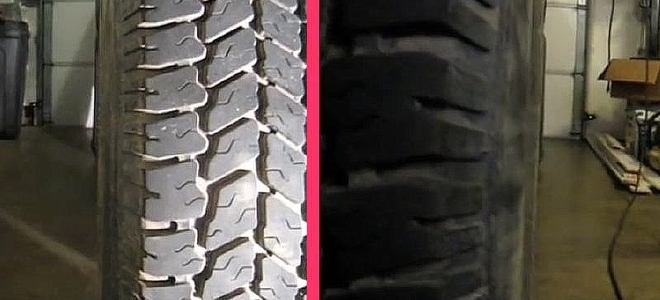

1 - Uneven Wear on Your Tires
As your tires wear down, you should notice roughly the same amount of wear and tear on both sides. However, if one side appears noticeably more worn than the other on any one of your vehicle's tires, this may very well be the result of improperly aligned front wheels. To catch this problem as soon as possible, make a point of giving your tires frequent checks.
