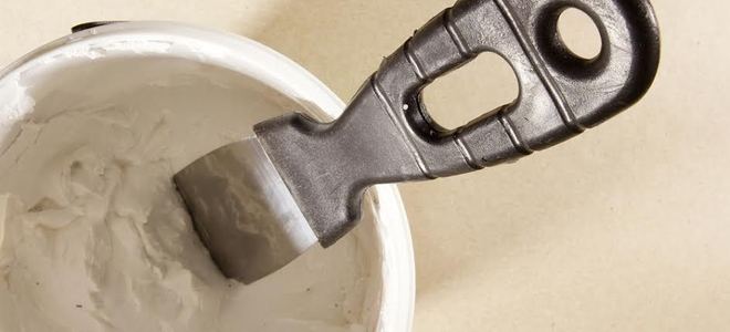

4 Different Uses for Plumber's Putty
Plumber’s putty is a substance used to make watertight seals between pipes and countertops. It will remain soft for a long while after it is used. This characteristic makes plumber's putty ideal for seals you will need to reverse. Because it does stay soft for such an extended amount of time, you shouldn't use plumber’s putty on pipes that will experience any amount of water pressure as the seals will not hold up to such pressure. The putty is fairly easy to use and can be wiped away if you make a mess. Read below to discover common uses for plumber's putty.
