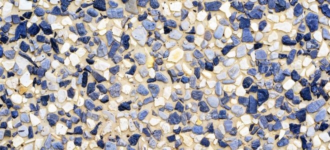

Aggregate concrete is a great choice for outdoor surface installations. It consists of concrete mixed with gravel or small pebbles to create a decorative effect. You can apply the aggregate with excellent results on your driveway, patio or sidewalk. When well installed, the concrete gives your home an attractive appearance. Many homeowners prefer to paint their aggregate. This creates an attractive display of color and allows you to accomplish your desired outdoor color scheme. When you paint, it also gives the concrete a fresh, new look. Below are 4 tips to help you paint your aggregate concrete.
