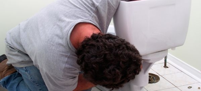

A toilet flange also called a closet flange, is located under the toilet. It secures the toilet to the floor and connects the drain to the pipe. If there is water on the floor around the toilet, or the toilet can be rocked back and forth, the flange is probably broken. The toilet needs to be removed so that a new flange can be installed. Follow these steps to complete the task properly.

Don't screw the flange until it is correctly positioned. The bolts slide into the flange and stick up. They have to be in the correct place to fit the toilet. They rise through the holes on each side of the toilet. Once the toilet is in place, tightening the washers will finish the job. Tighten them enough that the toilet doesn't move, but not too tightly. The porcelain might crack if they are too tight.
When prepared with the knowledge and the correct components, installing a toilet flange should not be difficult. This job can be done alone, but toilets are heavy. Having someone to help wouldn't hurt. Be ready for surprises; there could be mold under the toilet, and scraping up the old wax ring can be messy.
