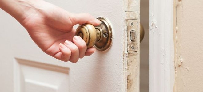

2. Check the Knob and Striker
The spring latch inside your knob is known as a striker. The striker pushes out and sets into the “striker plate” in the door jamb. If the striker is misaligned it may either be too high, too low, or if the door does not close fully, the striker may bind.
This is indicated by a door that closes but pulls open with anyone turning the knob, a door that will not fully close, or a door that will not stay closed.
Position yourself so that the striker is at eye level. Mark the top and bottom of the striker with a pencil. This will show you whether the striker is high or low. Move the striker plate up or down as needed. Chisel out the jamb slightly to get a level fit. If the striker is aligned but not latching, move the plate out toward the front of the jamb.
