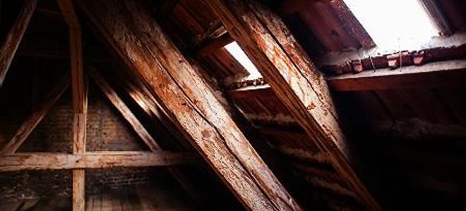

Installing an attic gable fan is something any home improvement fan should be able to do in a matter of hours. In that time, you can improve the circulation of air in your attic for decades. Heat in your attic is one of the reasons why your home gets so hot in the summer, and installing an attic fan can make your house much cooler in the warm part of the year.

The next step in installing an attic gable fan is measuring the fan and working out where it will fit inside the gable end of the roof. Consider where the louver of the fan will go and then begin to mark out an area where the fan will fit into the gable.
Don't install it too high, as this may interfere with beams supporting the roof. Instead, position the fan so it is in the center of the wall. You should place it near a power source if you are not using a self-powering fan. This will also require measurements for leads, wires, etc. Make sure you have all of this planned out before you make a cut into your gable wall.
