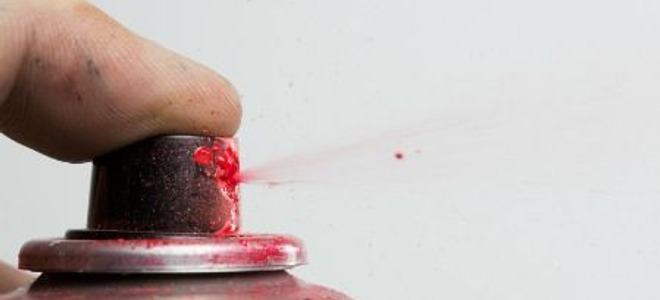

3. Spray Evenly from a Distance
Do not spray too close to the piece, as it will unevenly thicken the color on some parts. To create an even tone, spray from a distance. The recommended distance would be about 4 to 6 inches away from the object you are working on. This might seem like obvious advice, but it's important that you not only do this when you start painting, but also follow through with it throughout the entire process, even when you often stop and start and start a new layer.
When spraying, never begin or stop on the surface of your material. This will create drips and bunching up of colors, which can damage your paint job. Continue spraying in an even, single line from one end to the other. When you have sprayed in the single line from left to right, go slightly beyond the edge of the piece before releasing the trigger and stopping the spray. Then, do the same thing from right to left, repeating until done.
TIP: Painting professional Edward Kimble, the author of Interior House Painting Blog, adds, “The piece should be sprayed in several coats. The first coat is very light and does not cover the piece. We call this the “tack” coat. The next coat will stick to the tack coat and cover the piece. Don’t put the paint on heavy in one coat, or it will run. Usually, two to three light coats will finish the piece nicely with no runs.”
