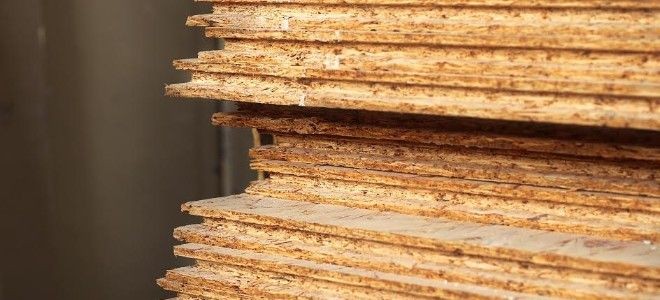

Because of special engineering and manufacturing processes, OSB sheathing can be used successfully for exterior walls, sub-flooring, and roof decking. The manufacturing process bonds wood strands, rather than wood plies used by manufacturers of plywood or pressed wood. These particles, when bonded with resin, produce a stronger and stiffer panel than other products used in similar types of construction projects.

Some OSB boards and panels can be custom ordered from the mill that produces them, but standard boards are finished without the usual knots, voids, and gaps often found in other types of wood composite panels. OSB boards typically are manufactured with smoother surfaces and nail lines that are marked during the manufacturing process. This marking makes installation faster and more efficient for workers who must attach these boards by nailing. Cupping, as often found in plywood sheets, is most often not found to be a problem in the OSB boards.

OSB board edges that are unsealed may swell when they are unprotected. Boards exposed to heavy moisture can swell and warp. These unprotected edges are vulnerable to water absorption and can expand as much as 15 percent. However, OSB boards and panels tend to shrink less rapidly than those made of plywood. Because of the absorption properties of OSB boards, contractors often prefer to use plywood on edges such as those found on roof decking that is exposed to weather conditions. For boards and decking installed away from exposed edges, the OSB material is used on these same roofs because of its lower cost.
