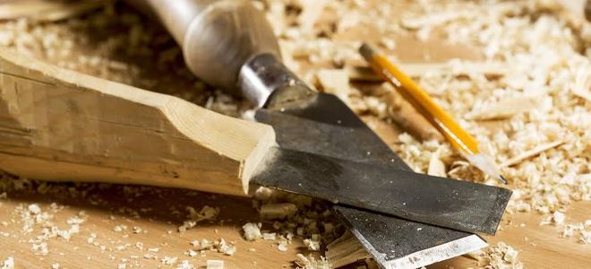

A chisel.
When you're working with wood turning chisels, safety is the number one priority. It's always important to know what you're working with and that little mistakes may cause minor or serious injuries. These safety precautions are especially important if you're new to wood turning chisels and woodworking in general.
It's safe to say that working with wood turning on a lathe is safer than most woodworking tools. Nevertheless, be aware that there are safety guidelines you should follow when using wood turning chisels. Take a look at some of them below.
