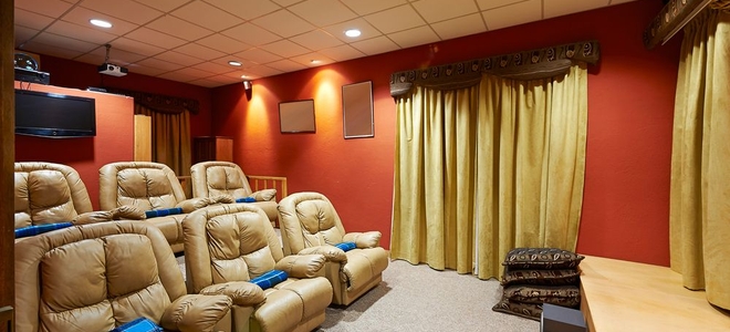

5. Windows and Doors
home theater
Hollow doors and outdated windows are notorious for letting noise in. If you cannot afford to replace both, start with the door. It should be solid wood. Windows ideally are double-paned with ample space between them. This can get expensive, though, so budget for the future if you cannot take care of it now.
6. Sound Dampeners
To dampen sound as it travels from outside, consider the use of heavy velvet curtains over windows, even the entrance door. In the absence of a solid door and the right windows, thickly draped curtains can make a big difference.
