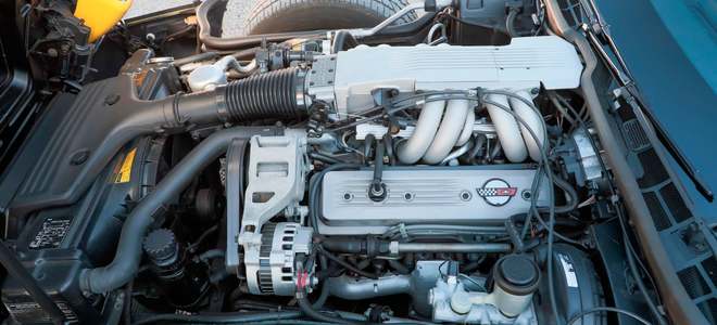

Step 1 - Disconnect the Battery
You first need to open the cars bonnet and then locate the cars battery, if your car has a sound proofed cover then this might need to be removed first. Once you can see the battery you then need to disconnect the negative battery cable. Make sure that you start with the negative cable (black).
