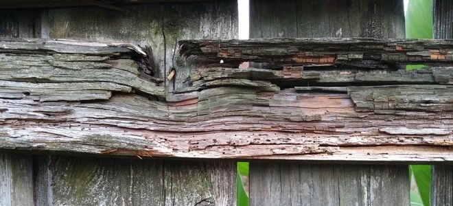

7. Thinking All Wood is Good Wood
Wooden fences are the most common type of fence, but they often don't last as long as wrought iron or aluminum fences. This is not because wood is not durable—countless ancient wooden furniture pieces prove the opposite—it's usually the result of poor decisions.
If you just pick up a bunch of untreated wooden posts from your local merchant and use them on your fence, they will most likely rot when exposed to water, or be damaged by ants and other insects. When you buy your wooden posts, look for materials already treated for outdoor use. If you can't find those, purchase wood preservative and apply it yourself.
The best and most affordable types of wood for fencing are pressure treated pine, cypress, red cedar, and white oak. Unlike other common woods, these don't warp or shrink easily, and can withstand a higher level of hostile conditions. Avoid woods like spruce and eucalyptus, as they have a low resistance to moisture, and warp more easily.
