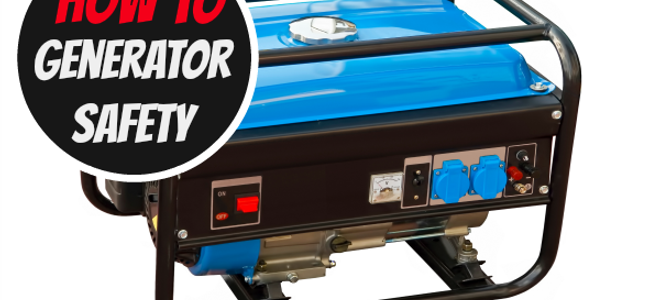

A portable generator.
Power generators can be a lifeline for you and your family in the event you experience a blackout. Properly maintaining your generator is vital to ensuring that it works when you need it. Improper usage of a generator can lead to it malfunctioning or worse, causing a fire and putting your family in danger. By following some simple steps, your generator should be able to provide you with the safety and power security you need during a power outage.
