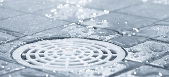

Make Precise Joins for the Drain Pipe Assembly
Use the drain fitting tool supplied with the shower base kit to thread the drain pipe to the drain hole precisely. Fit all washers tightly against the drain pipe nut before attaching the drain pipe assembly.
