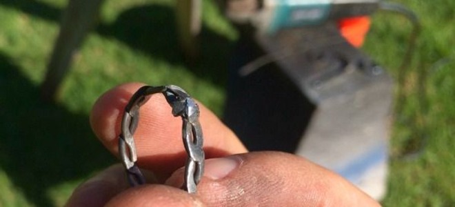

Snip the ring to size, creating a little kink at the end. Instead of the two ends butting together, they should meet at a tiny peak. Set your wire welder to its lowest setting and its slowest feed speed. Clamp the ring closed, set the wire in the peak, and pop a weld. Pop one more on the other side of the peak.

I used an angle grinder with a 120 grit disk. You could use a belt sander, sand paper, emery cloth or sanding sponge. If you skip this step the ring will be a dark, charcoal gray, and if that’s okay with you it’s okay with me.
A Maker’s Valentine Solution: Baling Wire Ring, Justin DiPego
But you do have to address the weld (or the twist-tie).
Knock down any sharp edges or errant slag. While you’re doing this you can create little facets that will catch the light like a crystal.
