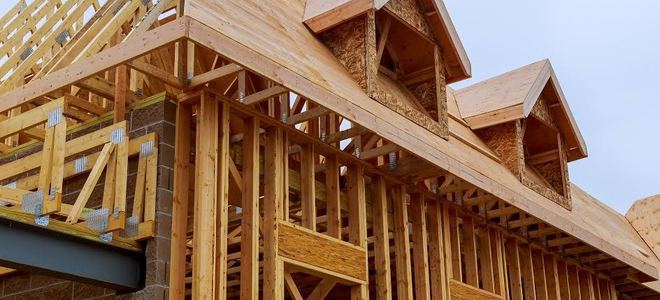

framed house under construction
In wood frame construction, house framing involves the erection of the wood frame’s structural components (studs, rafters, joists) onto which sheetrock, sheathing, roofing, and exterior cladding will be installed. Framing is a critical part of the construction process and requires a certain amount of skill. Knowing when to do it yourself or hire the services of a professional is key to the success of your project.

Layout and Frame the Walls
framed walls of a house under construction
First, mark the layout of the floor plan onto either a concrete slab or plywood decking with a chalk line. These lines give the exact location of the bottom plate of the walls to be erected. The walls consist of a two by four top plate and bottom plate and two by four studs at 16 inches on center. Each wall is constructed separately with the rough window and door openings in the appropriate locations, and laid out flat in position. They are then tilted upright into place, made plumb, and nailed together.
