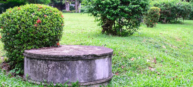

A diverter valve in a septic system is used to divert the waste from one drain field to the other. The principles of a diverter valve in this scenario is very similar to that of a diverter valve that is used in common household applications such as showerheads. If you have more than one drain field or leech field, then you may want to consider adding a diverter valve to your septic system. Below are instructions on how to accomplish this project.

Step 3 - Locate the Septic Tank Piping
sewer pipes
Every system is designed and installed differently. Either pull out your diagrams or check the manufacturer's installation information on where your source piping can be found on the septic system.
