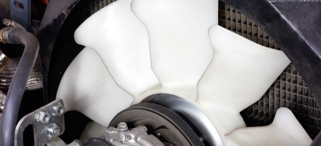

Adding a manual switch to an electric radiator fan is an economical way of keeping your car cool and in good condition. If you're rusty or new to this automotive element, here's a short rundown of how radiator fans work. Electric radiator fans operate when radiator temperature rises to preset heat range. When the radiator temperature lowers to a preset level, the electric fan turns off.
Adding a manual switch can essentially be a one-two punch, once you know what you're looking for. Open hood and look at front of car to locate radiator and fan inside engine compartment. If you are unable to find an electric fan attached to you radiator but there is a fan with a rubber belt around its pulley, then this article will not apply to your vehicle. If you are able to find an electric fan, then read on.
The fan will have electric wiring coming out of its motor and going into a wiring harness. This wiring harness is where you will concentrate your efforts. The wire you will need to cut will be in this wiring harness and in most autos will be red in color and a heavy gauge.
