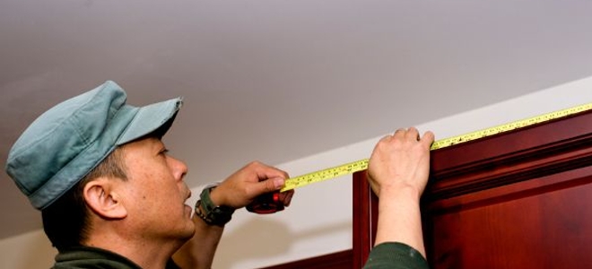

measuring at cabinets

Step 1 - Mark the Placement Lines
Before placing a semi-concealed hinge onto a cabinet door, you have to first measure and mark the place where it will go. Begin with the bottom hinge, measure up 3-inches and make a mark. Repeat from the top of the door , making a mark at exactly 3-inches. This will ensure that the top and bottom hinges are exactly the same from the top and bottom of the cabinet door.
Step 2 - Attach the Hinges to the Door
Once again begin with the bottom hinge. Line the bottom edge of the hinge up with the line that you have made. Use a level to ensure that they hinge is properly positioned, and then drill pilot holes into the wood where the screw holes will be. Tighten one screw at a time, making sure that the hinge stays flush with the edge and level to the wood cabinet door. Repeat these steps for the top hinge, making sure that the top of hinge follows the line that you previously made.
