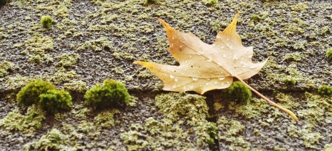

Asphalt roof repair isn’t too difficult and it’s something most people should learn. This is because an asphalt roof is the most common type of house roof so sooner or later, you may need to repair one. You can pay a professional to do the work but in most instances, you can carry out the asphalt roof repair yourself.
Weather
You should always carry out asphalt roof repair when the weather is warm. You need to do this because the asphalt can crack in cold weather which is the last thing you want when you’re working on it.
In the warmer weather, the asphalt will be more malleable and easier to work with so the asphalt roof repair will go faster and be more effective. Consider the fact that you only see new asphalt roofs being installed in the summer or fall, before the weather turns cold.
