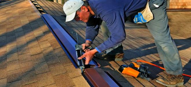

Step 2 -Install the Ridge Vent
Use a utility knife to remove the felt paper and then pull out the staples and roofing nails. Put down a chalk line in a 6 inch perimeter around the ridge and use this as a guide for your circular saw as you cut a channel out of the roof sheathing. Leave the joists alone.
Step 3 - Finish the Job
Now, using staples or roofing nails, fix whatever permeable material you are using as your ridge vent over this channel. After that, cover the vent with a cap. This could be either a metal piece or special shingles designed to leave the airflow from the vent unobstructed.
