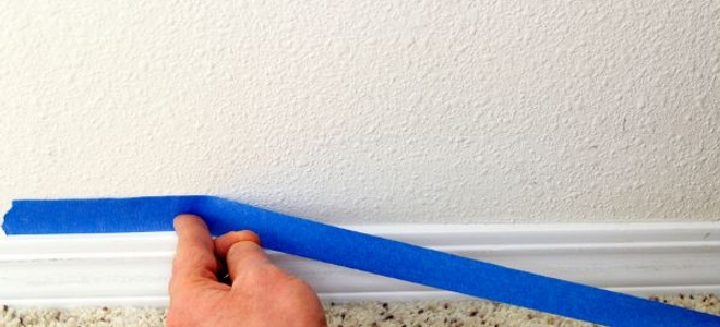

Give Attention to Trim
Paint the walls first and then the trim, not vice versa. You can get a little wall paint on the baseboards and window frames because it will be covered when you paint the trim. To keep things neat, put two-inch masking tape on the carpet before painting baseboards. Pull the tape off when the paint on it dries. Leaving the tape on overnight is OK, but it's a common mistake to let it sit for a week and then try to remove it, which can be difficult and cause damage.
When taping off windows, don't put masking tape on the glass. Instead, paint about 1/16 of an inch onto the glass and remove it with a single-edged razor blade when it's dry. This seals the windows. Again, it's a common mistake to let the paint sit on the windows for a week, making it very hard to remove after the fact. Razor it off right after it's dry.
