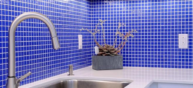

There are various reasons why a homeowner might wish to attempt a backsplash tile removal project. You, as a homeowner, may be planning a remodel or re-decoration project. Or, your current tile may be cracked, broken, or chipped, and you would like to replace it with new tile. Whatever your reason for removing your existing tile, you should know that this type of project is not simply a matter of breaking up the tile and installing replacement tile. There are tricks you will need to know to avoid creating a bigger problem than you may have anticipated.

To remove your old tile without creating damage to the drywall your tile is attached to or to the tile you'll want to leave in place, you'll need to survey the tile. Determine how your backsplash tile interconnects with your countertop tile. Does the tile on both of these surfaces come together evenly? Or does the bottom edge of the bottom backsplash tile have a beveled edge that allows for a curved transition to the countertop tile? Will you be removing both the backsplash tile and the countertop tile? Answers to these questions will help you determine how you will remove your old tile.
