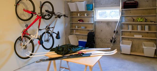

Organization is simple using shelves, bins, and racks. Basements are typically constructed with concrete floors and walls. Install your organization system using drop-in concrete anchors and create a sturdy storage structure. Drop-in anchors are suitable for light to heavy load applications and they are easy to install.
Step 1 - Shelves, Bins or Racks?
Begin your installation by assessing your needs for basement storage. First, create a list of all the things you would like to store. Add room for expansion. Then organize your list into storage groups and visualize how best each group can fit into shelves, bins or racks. Save your list as an inventory.
Shelving is most suitable if you need the flexibility to change your plan or store different size objects and containers. Shelving installed using a standard shelf and bracket system offers layout flexibility as shelving can be easily added, deleted, and moved around by simply moving the brackets to different slots on the shelf standards. Shelving will support light to medium weight objects and books.
Bins are nice if you have lots of the small objects that you don’t mind mixing together. Bins are ideal for storing loose objects that otherwise would be difficult to contain. Bins can also protect your storage from dust, humidity, and rodents in your basement.
Racks are great for large or heavy objects that are self contained. Well marked, heavy duty cartons or crates work best on racking systems. You can assemble sturdy basement racking systems using low cost, basic hardware supplies.
