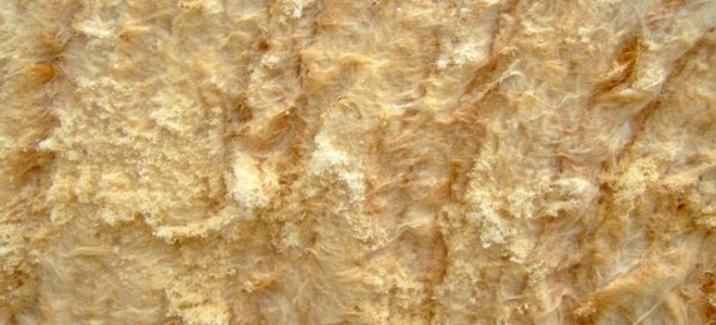

If you are not heating the basement or crawl space, insulate underneath the first floor. Install fiberglass insulation between the joists with the vapor barrier up toward the heated area. If the basement will be heated, then you need to insulate the basement walls. Use either closed-cell rigid foam panel or the reflective layered insulation.
