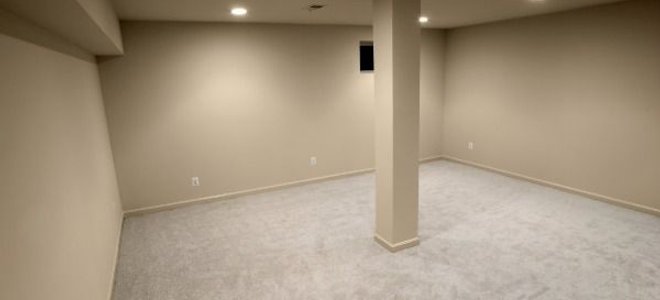

finished basement
Q. I live in Boston and have a finished basement with a tile floor. When the temperature outside reaches 85 degrees, my basement's floor and cold water pipe get as wet as a shower, but just some areas and not the whole basement. The basement has four windows, but I can only open two. Does it get too humid down there? What should I do to get rid of the water?
A. It sounds like you have condensation. When the warm, humid air enters the basement through the open windows, it will condense on colder surfaces. To eliminate the water and condensation, you have a few choices.
You can warm the surfaces which are impractical and very costly making it a poor choice because the air will still be humid. It is better to eliminate the warm, humid air. Doing so requires closing the windows and running a dehumidifier. Running a dehumidifier with the windows open is not an option. The windows must be kept closed until the temperature is much colder and the air is much less humid; therefore, it carried much less water.
